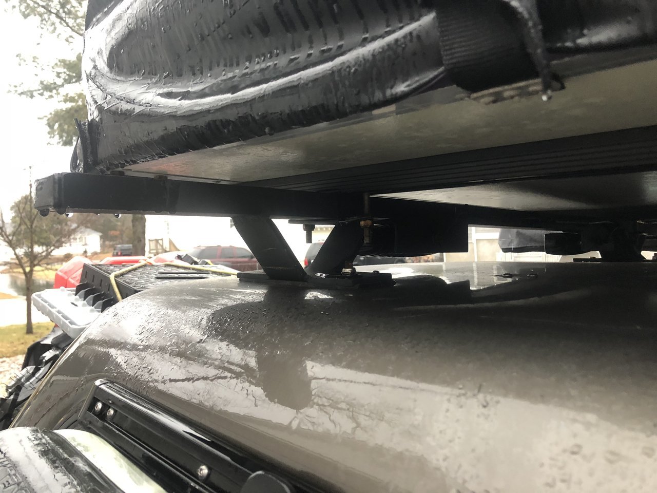

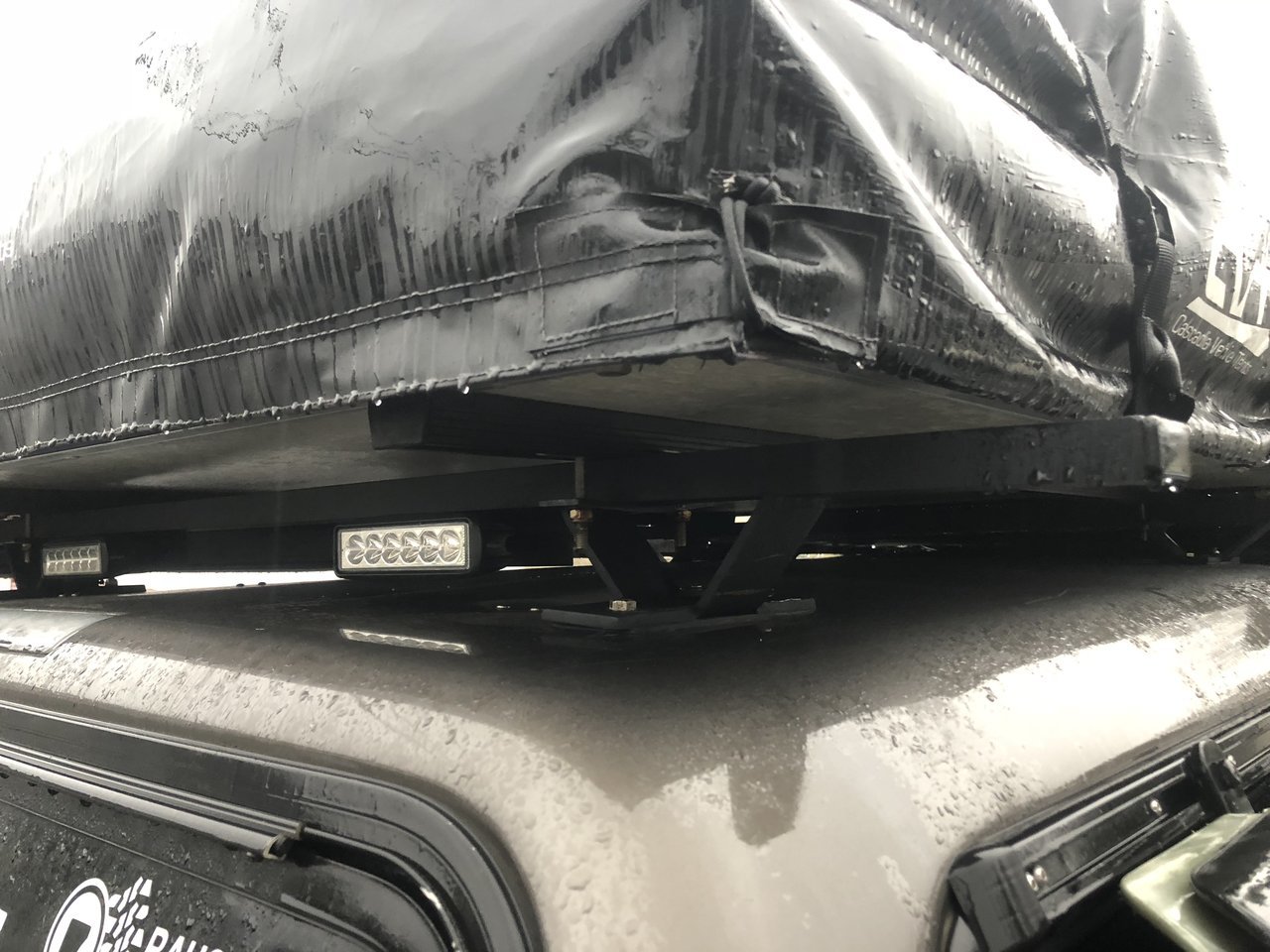

    The rivets broke on the mounts so I threw them out. Ended up making my own crossbars..
    https://youtu.be/mZgjX6HRqaU

    No but seriously. They wouldn’t be hard to remake, I chose aluminum and right now I can’t do aluminum work. When I designed them and fabbed the pieces I went to a buddy house to Tig them up. It’s a ways away just to cruise over there again. A lot of local guys are laying good mig welds, you can easily do it out of steel. Are you going to drill through the cap to mount them or get the Thule track system for the cap?

    If I got the Thule type I'd install the rail. If I was to get something fabbed like this I would drill right through. The cap isn't in bad shape but isn't perfect either so I'm not concerned with holes.

    Gotchya. If you look at the fail video again you really don’t need the tracks for the Thule mounts, at least the ones I had. I drilled and bolted them through the cap. Save ya like $100 on the tracks. Going back I think I would get them tho, maybe dispurse weight more evenly.. That’s if you plan on a basket with firewood or gear or even RTT. My basket I made was on the heavy side and I would load it up with everything. All that weight going off road is what I believe caused the Thule cross bar mounts to fail. Not sure what they are rated for but definetly not intended for overlanding.

    Cool thanks. No RTT for me. Just want to move my powderhounds and awning back further and possibly an additional plano box for when I can't fit it in the bed. The weight won't be anything substantial.

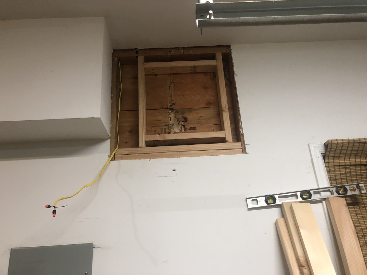

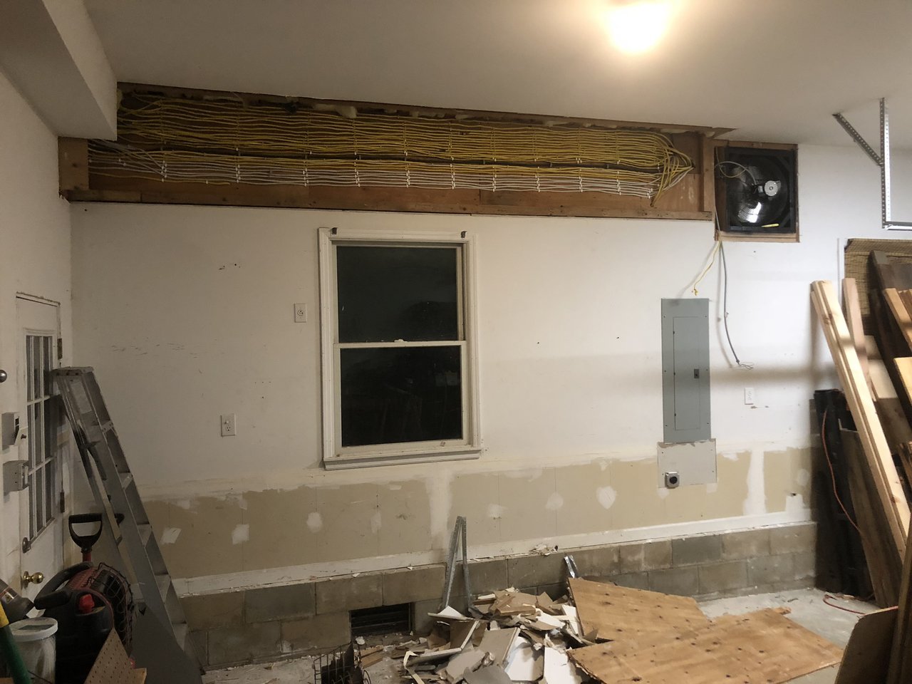

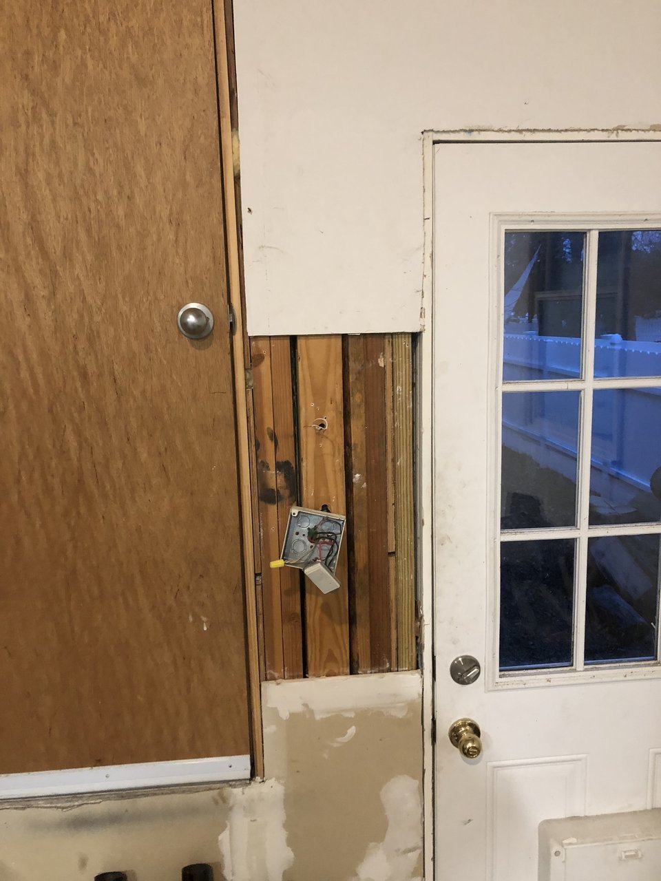

    Garage build continues.. I wanted to get all my project lumber off the ground so I was thinking bout making some racks to go on a bumpout in the garage. Turns out the bump out is a large void to conceal all the wiring going from the breaker box to the attic. Plan is to reinforce a false wall and add the lumber racks to that. Picked up some 3” strap plates and 1 1/2” square tube from the metal shop yesterday to make the racks. Before the false wall I’m running the switch from the exhaust fan to the back garage wall. Location I picked next to a light switch and garage door opener was perfect, all studs o_O
    I ended up notching out the stud for two gang boxes. One box will be ceiling lights and exhaust fan and the other will be garage door opener and ceiling fans. I saved the old ceiling fans from our house as we replaced them, they’ll be perfect to circulated the hot air that sits at the ceiling and keep things nice and cool in the summer..

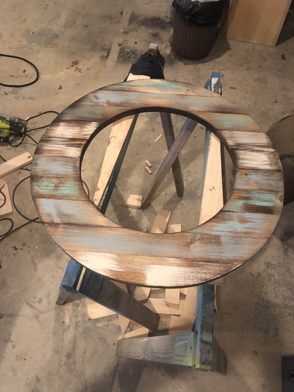

    I don’t post any wood projects here but I make a lot for our house. I’ve made foyer table, coffee table, triangle wall book shelf and plan to make a bed frame/head board for us as well as a dining room table. Here’s a mirror I finished up from December..

    And you can see the triangle wall shelf in the reflection
    Coffee table
