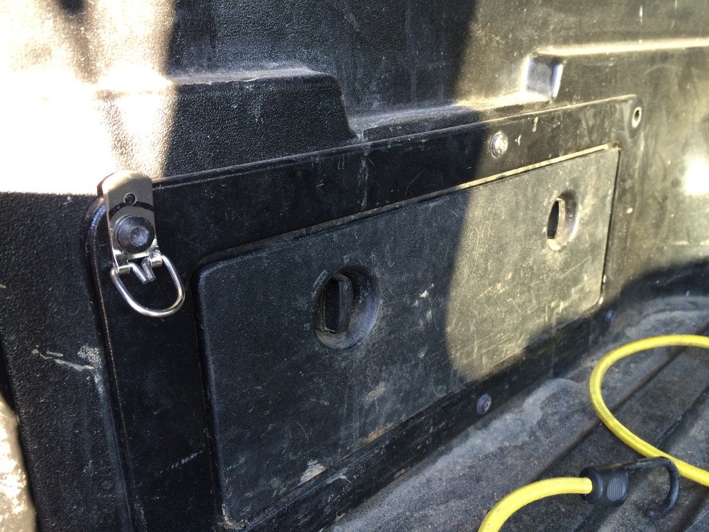

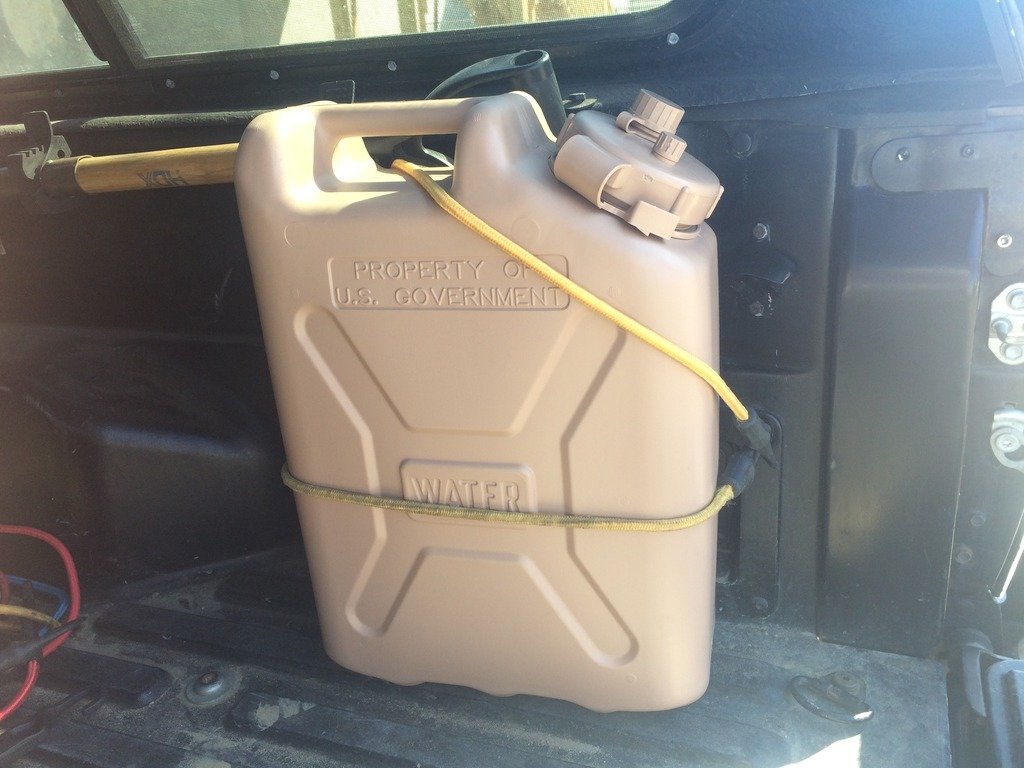

    Worked out a few things on the truck today
    F977BD51-17FB-4F6D-9A78-64432F1E836B_zps_57aa9aba11212778a67f69f1b99bc6b7c8e9d795.jpg

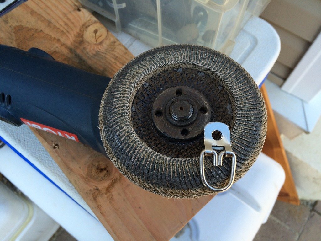

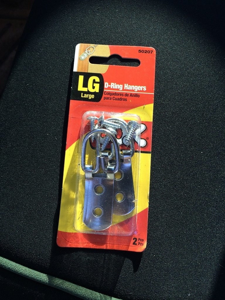

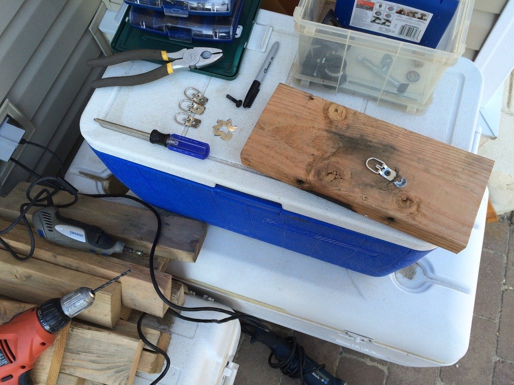

    Started this morning with a functional cheap mod I recently came across. So obvious you would never think of it :rolleyes: Wish I could find the link again to give OP credit. When I found this thread it was an alternative to a jerry can mount. But I saw more uses for it, like a secure spot to strap down a milk crate with propane tank or stretch the net you stole from your girlfriends Kia Soul :anonymous: across cubby to cubby to keep the groceries from sliding around. This was the end result the thread suggested
    74D06A16-A8DB-4B40-BAA5-919DB04EBDAC_zps_99eed5c58f78c099f23bd3230472abbaa215630b.jpg
    3C9DF024-74F9-4B30-AF13-347339D8CBB9_zps_8cddb620bd86188ef77942414ec1ddc424181981.jpg

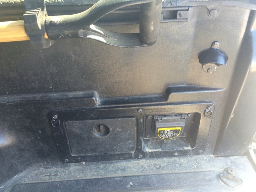

    I picked two sets of these up from the hardware store
    E44FA8F0-6C94-4A95-99F0-0EE42B8BDB65_zps_389da6c8f19ce1f84df85a46fb3898e4c31b43ac.jpg
    Drilled out the hole for the stock bolt and test fitted
    4C25C47F-8F6F-49B5-8333-F7538916C914_zps_b4d14688634c83774ed10712a42fd648a8f026c4.jpg
    Cut off the excess, rounded off the cuts, and painted them black
    5F83C42B-0664-41E3-AAA4-D566B6C3BEF1_zps_fa1f3960092d333b22c71a140cbb3833fe606631.jpg
    46FA5560-83D7-4B73-B516-DB87DAC81C10_zps_2eb3c4b118eec3f75461a9f6273443c355427ada.jpg
    174587CD-D6AC-44B6-9E86-88B33D767DA5_zps_d1b0ed8b548a0eeb9cac6c61dce919364c7289b2.jpg
    Great little mod with lots of potential.

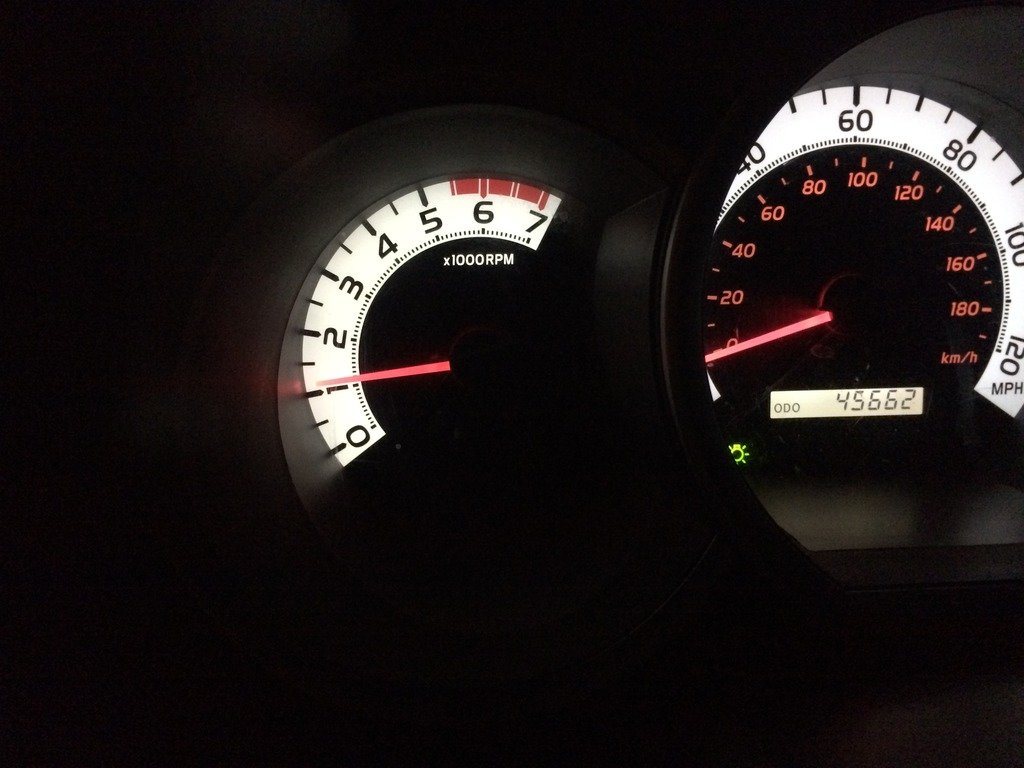

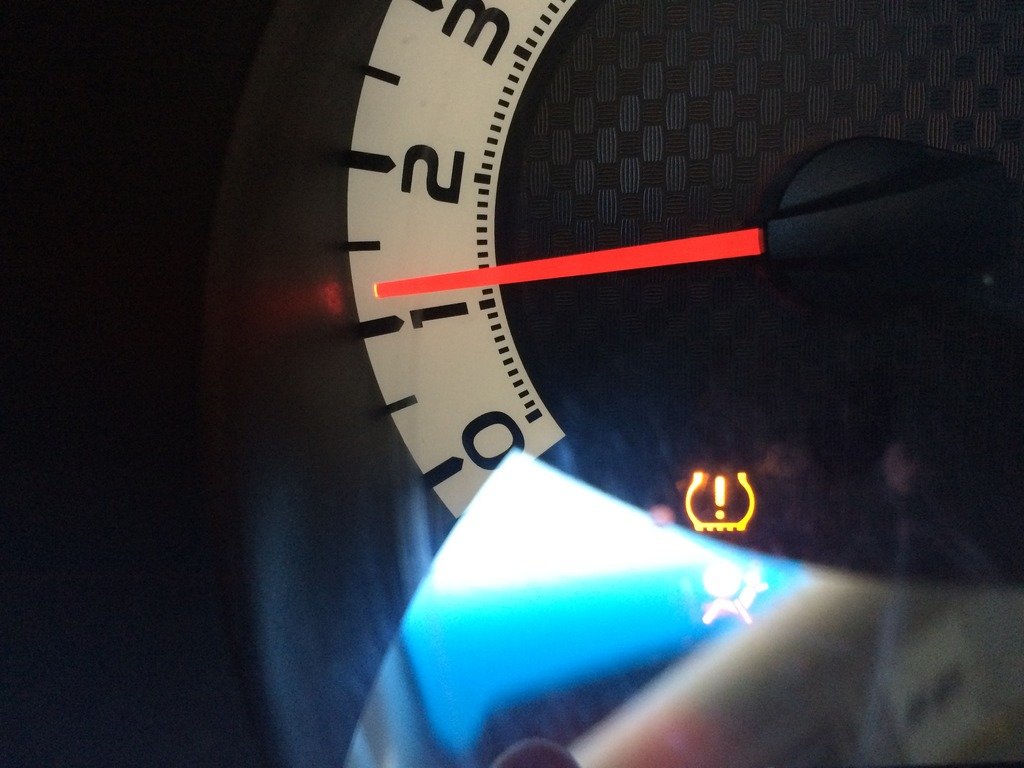

    Next up was TPMS indicator light delete mod. This thing has beenuseless for over a year..
    CF7250B2-8CA1-43C6-8145-0C0245B5DC00_zps_d2148fa689a224d97d926ec69909b531fb05dacf.jpg
    Link --> http://www.tacomaworld.com/forum/2nd-gen-tacomas/284690-2012-tpms-light-disabled.html
    Boom. Done.
    11CA132F-36F7-47AB-B41D-1A75820BF812_zps_8a3ab112781e37c53f05686e3585dae71827aa27.jpg

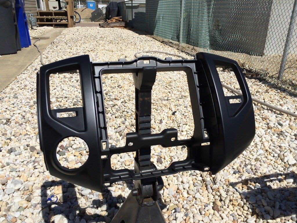

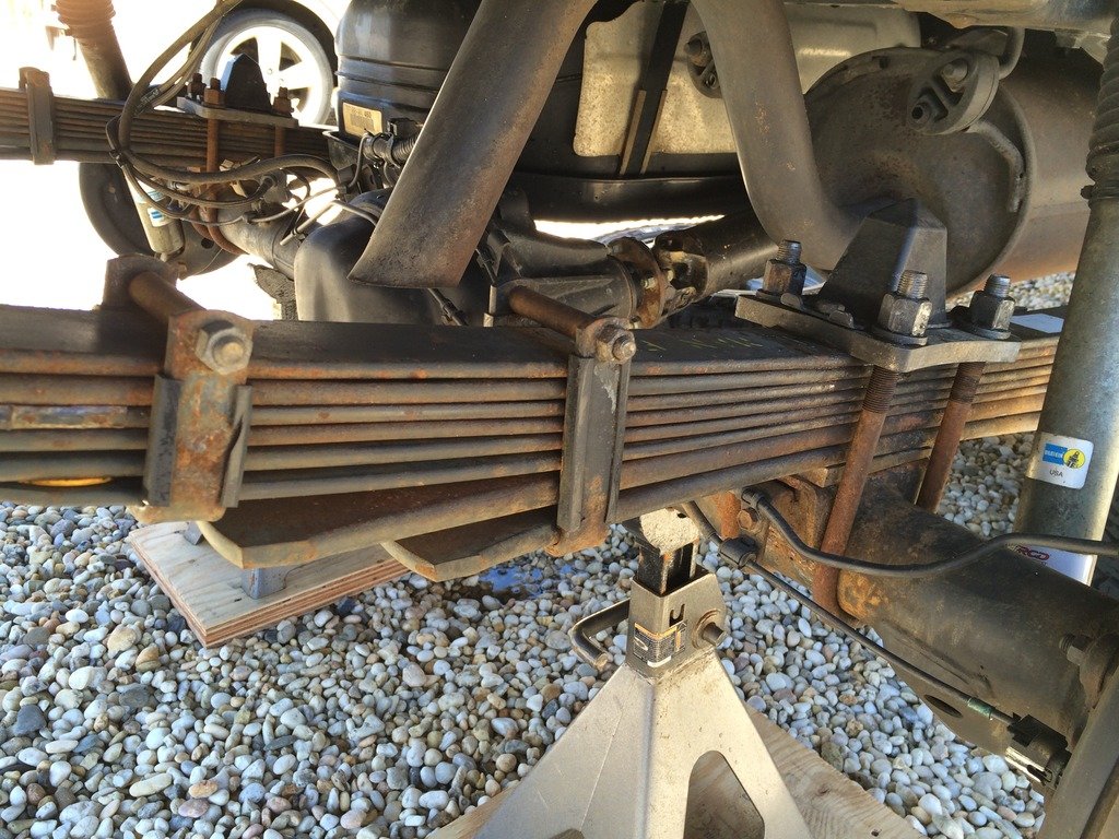

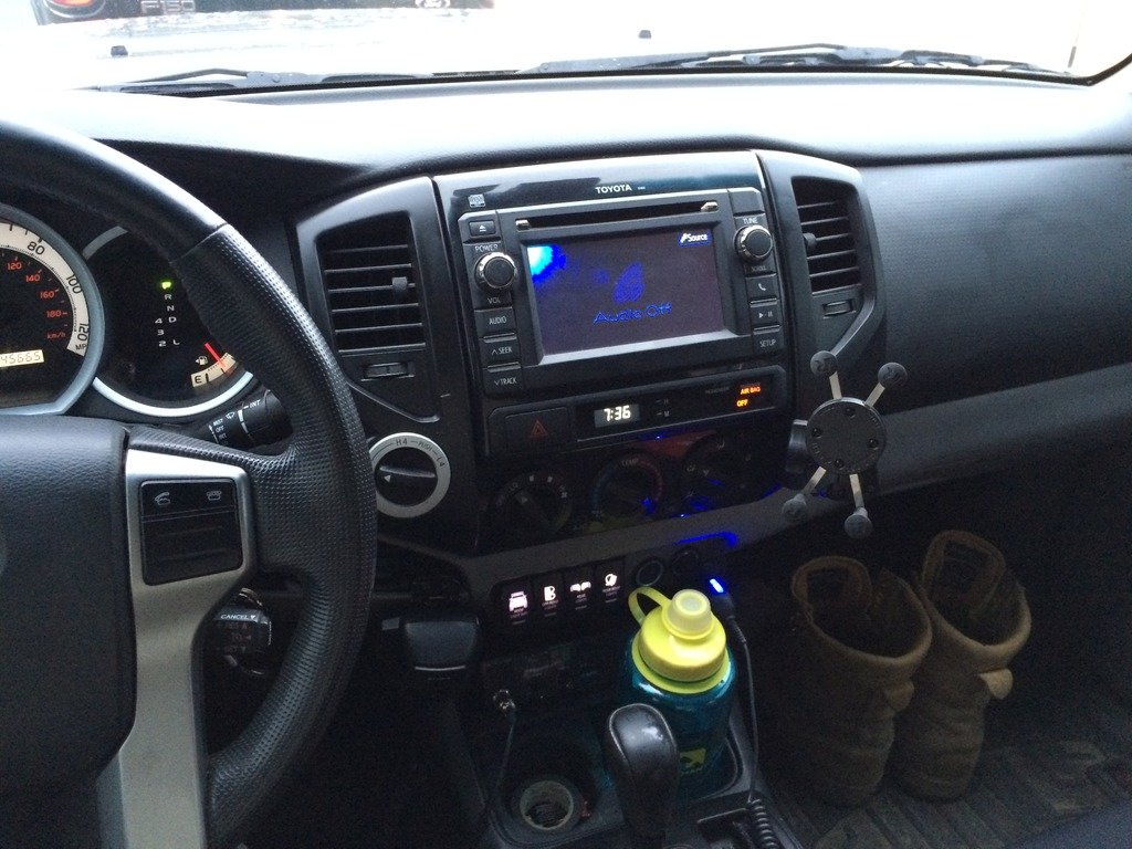

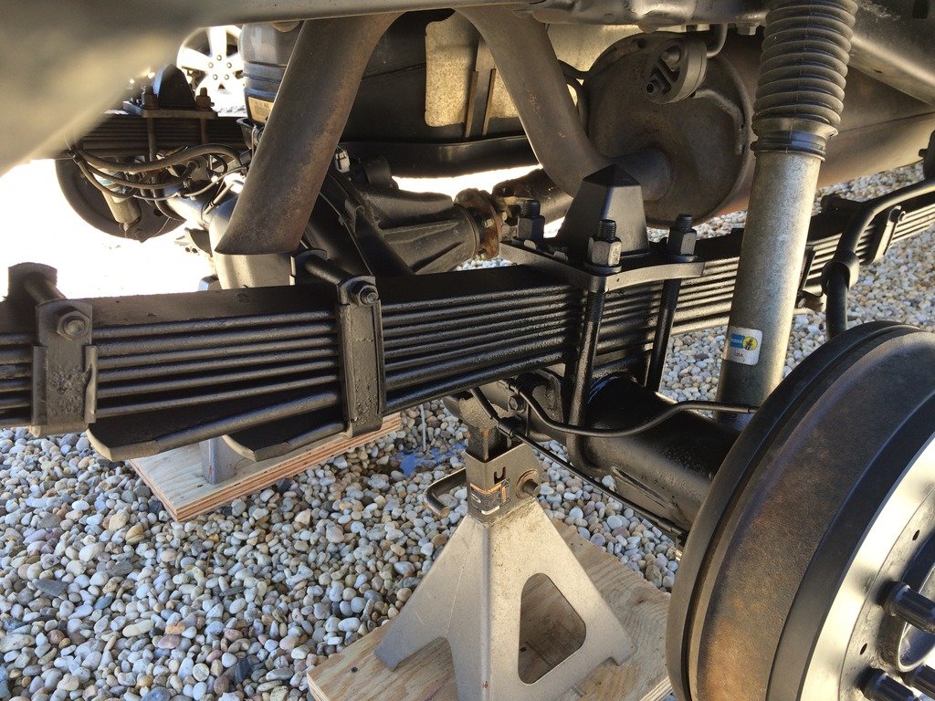

    Then I wanted to address the never ending battle against rust when your a Beach Buggy
    1ED98071-9539-4CBD-861F-A0E2BBD759A8_zps_038bc44aab5e17716f34db2b5ddcac4a24e8dde9.jpg
    4A6905BC-B1D0-4255-A736-1A15CF4DC702_zps_33ec767aa6d567d44465b0094e405439d7e8777b.jpg

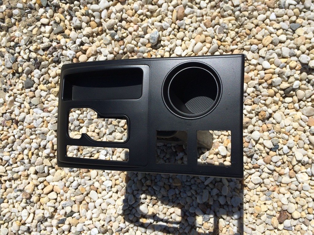

    While I had the dash torn apart I figured on having a paint party :D
    00A53368-87FC-4EC6-8087-7DD97A873F7E_zps_d64c2658ae6ad08b6dc7fb9d7d58828fcc470950.jpg
    D3E8BEB3-54A8-493C-AB66-2C3C76FF1217_zps_8f925e8dac22a88b6d5c3e550a2fdb0d9f9f236e.jpg
    FC0F9611-CF87-4551-9147-92096A32B449_zps_42a8f2f0644ad7d7cdd274001a3407fda80f0d71.jpg

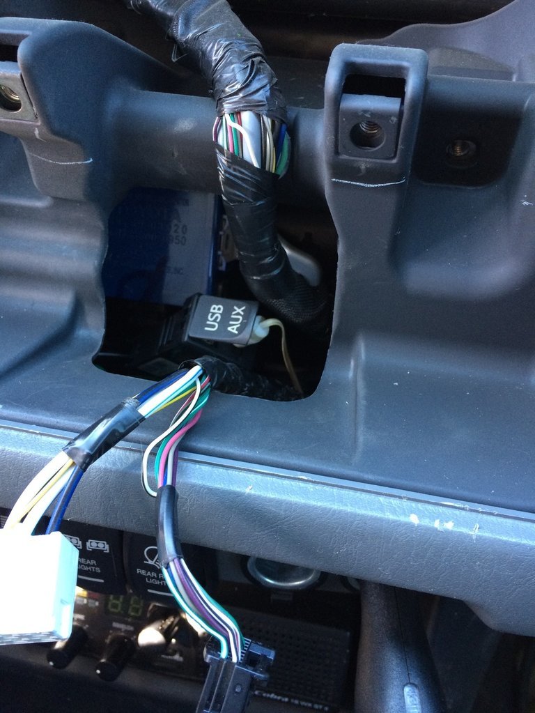

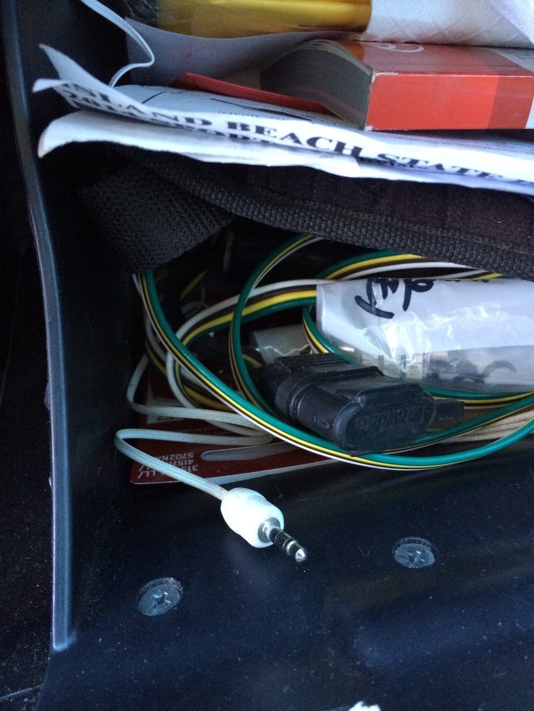

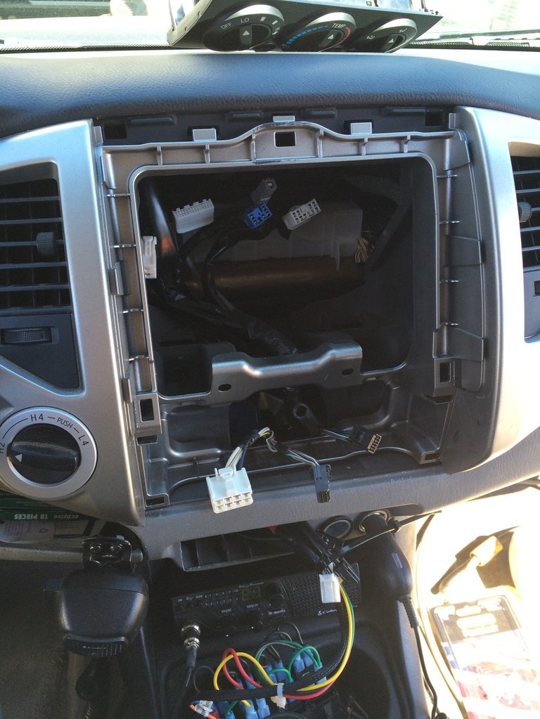

    Also ran into the USB/AUX harness that I deleted and stuffed away. I had an Idea of getting a mini jump pack kit from All 4 Off-Road and keeping it in the glove box always plugged in so its always good to go if needed. So I plugged the switch back into the harness ran a power cord to the glove box and restuffed it all back behind the dash.
    http://www.all4offroad.com/power.html
    A096E89D-83FA-4A12-BDC8-9D5260293377_zps_6266afef974475ee254d1101a51b709d93ac43c0.jpg
    6E00BDE4-C03E-4D0A-84BD-944A9B67479E_zps_71268f11e354a73cd085846d873e949bafced6a7.jpg

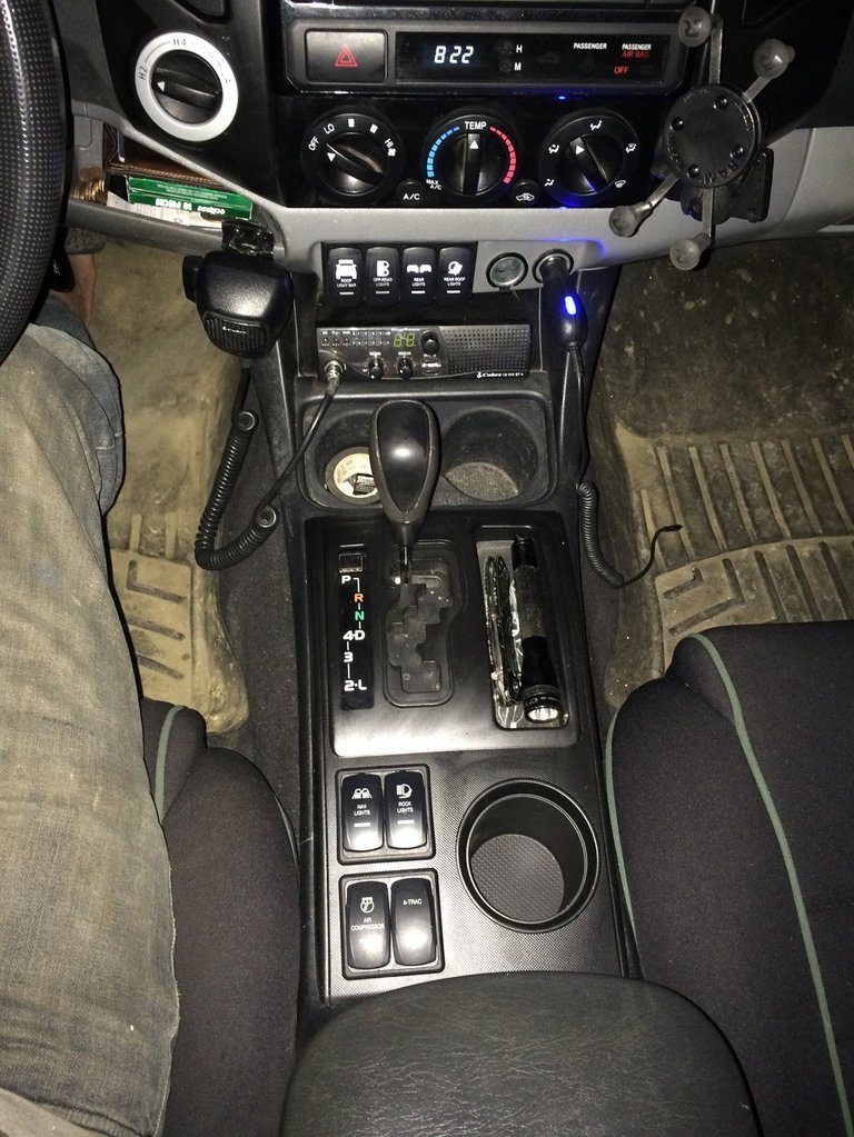

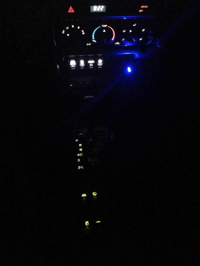

    Lastly, While everything was torn apart I ran the power and ground to all the switches next to the center cup holder. Soon to be wired in will be the A-tac system and OBA. Still two open switches available.
    59CA62DA-4278-4702-A9D7-82992B9D0392_zps_05f6f795b8bbd59b97332c95b1f2a746ee3a6888.jpg
    64F67AEA-4698-4E09-9011-DFE8ACDB98BE_zps_5899f57436af4def2b3b38b7afe7e92b55fe97f6.jpg
    Also did a tire rotation after an oil change a few days ago. All and all twas a good day :cool:

  17. Mar 30, 2015 at 4:18 AM

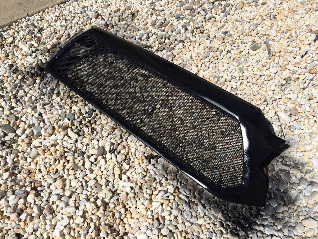

    Here's like a before and after, few small scratches reinstalling but overall good. And when I tare back into it I'll put a few more coats on.
    36D6FA8C-4046-4D4B-9F17-607A6AEF0CF5_zps_231f1c7c623a2b14ddebfb6e0fb801033d0d5dfd.jpg
    EBE87EEA-CF26-4E36-8D40-673A44FBA62F_zps_efe1467f8b7a50887843f792a455fd7169de515c.jpg
  19. Mar 30, 2015 at 5:08 AM
    #839
    JLink
    JLink Well-Known Member
    May 9, 2010
    #36795
    12,582
    Josh
    Ocean, NJ
    Lifted, Locked, Armored. Ready To Wheel.
    Nice work man. Got a lot done this weekend
  20. Mar 30, 2015 at 7:52 AM
    #840
    ragincajun35
    ragincajun35 Well-Known Member
    Jul 4, 2013
    #107595
    3,001
    Spencer
    Louisiana
    2015 DCSB MG TRD Offroad
    See Builds....
    WOW dude!!! That looks awesome. Its all about the little things sometimes.
