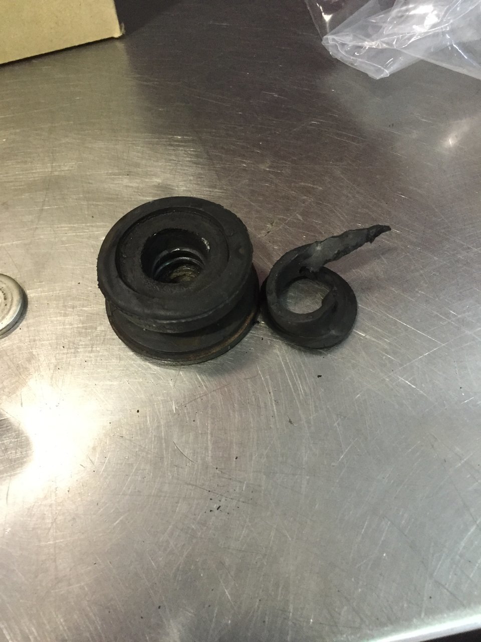

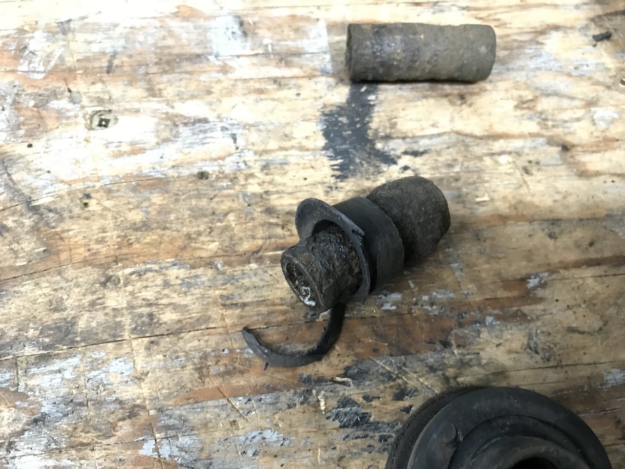

    I had this noise from my front end for almost a year on my 11 and finally got it to go away when I replace the front body mounts near radiator. It would drive me nuts when I would hit speed bumps or potholes now it is quiet again. I have read that it is a problem on the third gen as well. I would try replacing the mounts if you have not tried it. I replaced several parts before this solved the issue.

    Get these replaced, sound goes away

    My 2nd gen makes the noise like the first video. I replaced everything, torqued everything and replacing the front rad support mounts with poly ones helped the most. Now it only creaks over large hits. I work in the woods so it was getting annoying
    Removing the front sway bar helped as well, I feel it puts a lot of flexing pressure on the front of the frame
