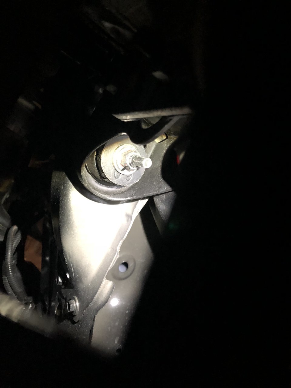

  13. Dec 3, 2017 at 5:16 PM
    #113
    RevivalOL
    RevivalOL Well-Known Member
    Sep 13, 2017
    #229920
    375
    Pete
    Berkley, MI
    2017 TRD Off-Road DCLB
    I know this is a crappy picture, but does this look like the radiator/body mount? If so, I can see some degraded rubber already.
  14. Dec 3, 2017 at 5:27 PM
    #114
    Northern Taco
    Northern Taco Well-Known Member
    Oct 8, 2015
    #166156
    2,820
    2022 Tacoma trd off road premium 2023 tundra trd off road
    Hard to tell, but that's a body mount and if it's at the front of the truck then it's your rad support mount.
    Mine looked like this
    RevivalOL likes this.
