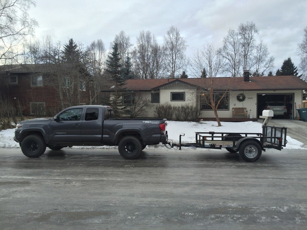

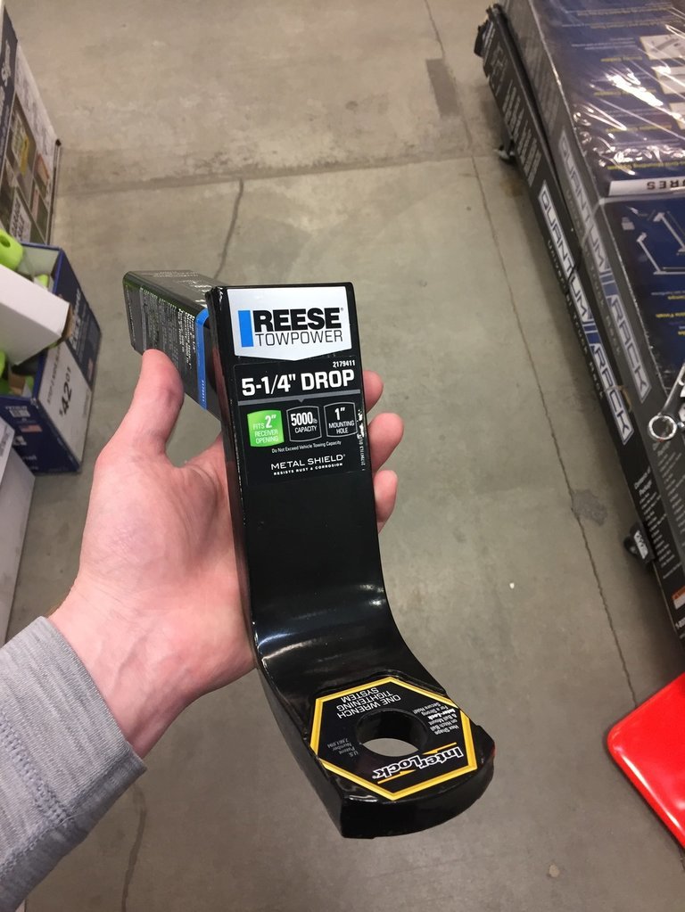

    I measured and decided upon a 5 1/4" drop to pull my utility trailer.
    I have stock suspension and it seems pretty level but the trailer is empty. I do have about 130 pounds of weight in the bed.
