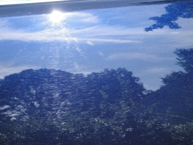

    To give you a more direct answer to your original question; Yes, you still need to clay the surface despite washing it every week. Furthermore, I would advise against washing every week b/c you'll increase the likelyhood of inducing swirls and spiderwebbing that will require polishing.

    what kind of spiderwebbing? i use the softest stuff for the paint when i wash it plus i dont want waterspots.

    Waterspots are not caused by wash frequency or product hardness though. Waterspots are mineral/calcium deposits left on (or below) the surface from not drying the surface or having very poor water quality that transcends drying techniques. You can cut down the chance of spotting by using a filter. That's probably the single most effective thing you can do to reduce the chance of spotting. Other, more obvious, things you can do would be to always wash in the shade and dry the surface immediately after washing. But I would go with an inline filter if you're really worried about it.
    As for spiderwebbing, heres a picture of what I'm basically referring to.
