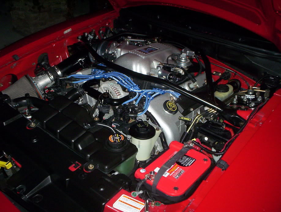

    my old cobra using the method above.

    Not fair Vin, I bet that thing was never dirty!

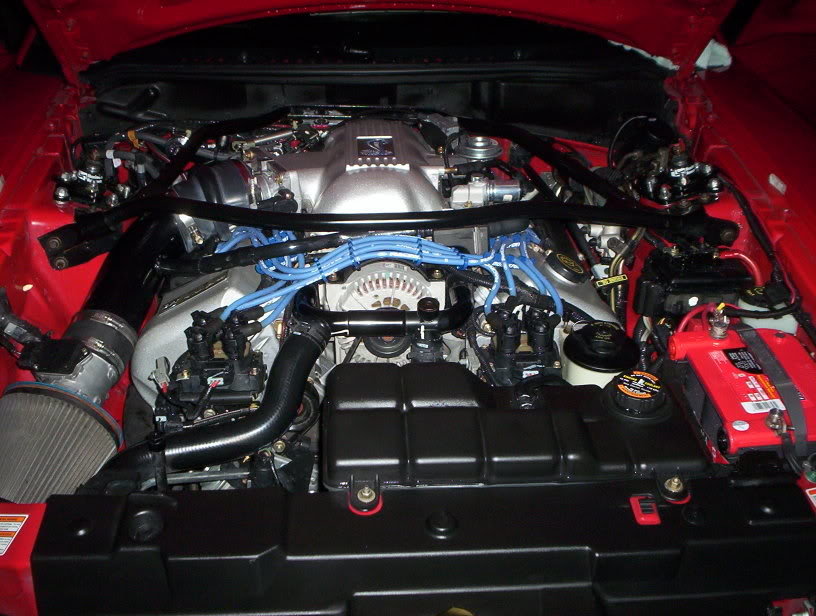

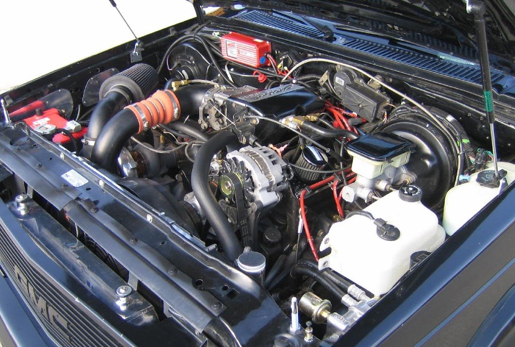

    Since we're posting pictures to prove our method works here's my Typhoon that was over 15yrs old and over 180k miles and you could eat off of it. I have two vehicles now that are less than a year old that aren't as clean as the underhood of this bad boy.
    If we have to keep posting pictures I could fill a few pages with engine pics that are all spotless to prove my method works. Engine degreaser was ENGINEERED to clean engines and nothing else. It's sole existence on the face of this earth is to clean engines. 'nuff said.

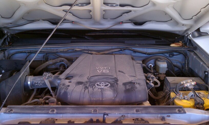

    this is what my engine looks like. i don't really plan on cleaning it :D
