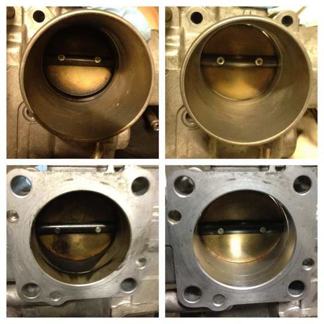

    Throttle body is straight forward... I removed mine so I could clean behind the butterfly plate and not get gunk in my IAC holes. 2 screws, 2 nuts, and 3 sensors to do this. If you do this, replace the gasket. A toothbrush is extremely helpful!

    Some TB pics before and after... Front and back... You can see the build up on the backside which is why I remove mine when cleaning. And yes I cleaned up the mating surface before reinstalling :)
