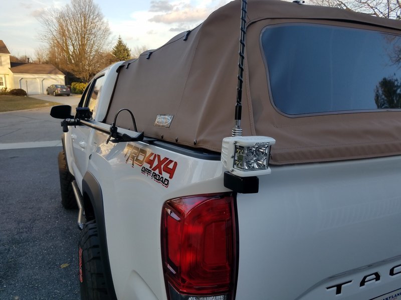

    Here is my setup. Wanted something I can mount a light to as well.

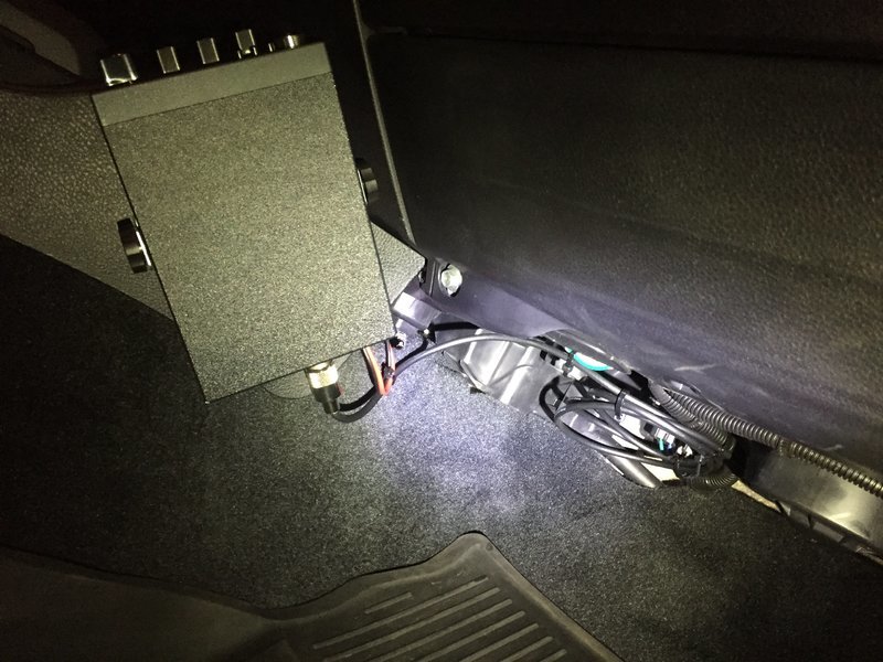

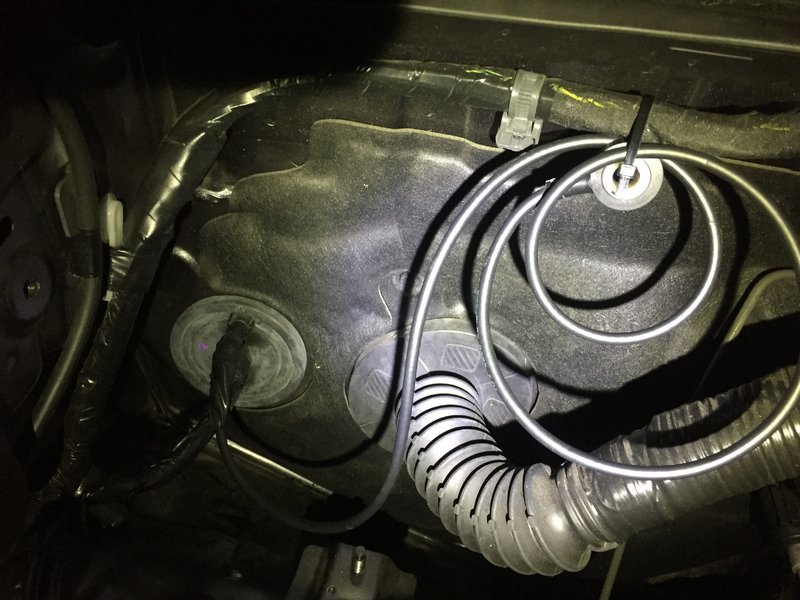

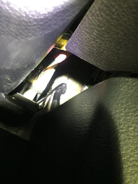

  15. Apr 26, 2017 at 7:53 PM
    #235
    0331
    0331 Well-Known Member
    Aug 15, 2016
    #194697
    398
    Seattle
    16' DCSB TRD OR 6MT
    Found pretty easy access through firewall on passenger side..IMG_0979.jpgIMG_0981.jpgIMG_0982.jpgIMG_0965.jpg
