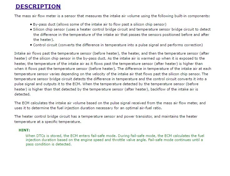

    I won't bore everyone with the background on my little dilemma I seem to be facing. Long story short, it seems the oil on my K&N filter might have gotten sucked up into the intake and is the culprit of a rough start when the engine is cold. As a result, I need to clean my MAF sensor. I was about to pick up a bottle of CRC MAF sensor cleaner when I read that you should not use the product on Kármán vortex type sensors. An example was a Supra and I have read that other Toyota's also use this sort of MAF sensor. Even though the V6 engine is very high performance like a Supra (sarcasm), it's not turbocharged so hopefully we don't have that type of sensor. Can anyone confirm that the V6 does not use a Kármán vortex sensor? Has anyone else cleaned their MAF sensor yet?

    Sounds like a hot wire MAF to me; no mention of a photocell.

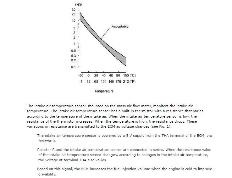

    Now that's some research! Seems like I should have done some more digging on my own..thanks!
