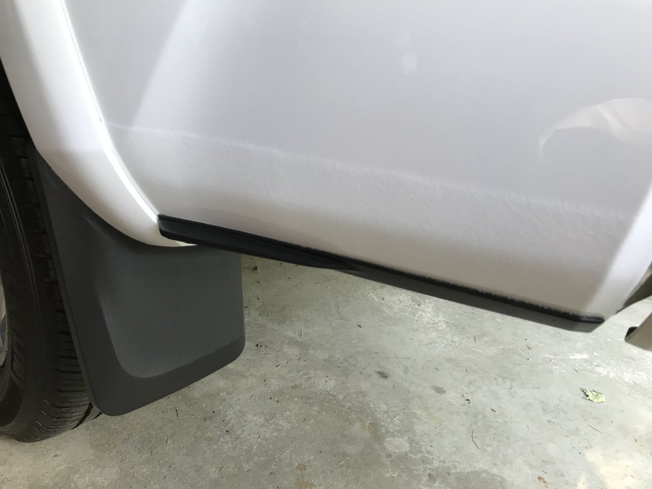

    I did a little search and didn't see anything that specifically answered my question. Anyways, I have a white Tacoma and the clear protection film near the rear fenders is starting to get a little yellowish and has a dirt line around the edges.
    I keep my truck fairly clean and have tried rubbing the line around the edges away with no luck. Is there a cleaner out there for removing the yellowish tint to the film itself that anyone has tried? I saw a couple products online but don't have any experience with it. And a technique for removing the dirt line around the edges?

    I thought about that too, but was afraid of any damage it might do to the paint. That and the fact it looks like it goes under the rear fender "bump out" and the little black strip outlining it.

    I tried everything however nothing works. A hair dryer removes it easy!

    You might try magic eraser for the dirt line but im sure that wont help the yellowing if the film itself.

    We install this stuff at my work, there isn't much you can do about the yellowing but for the dirt edge use a tooth pick.

    EDIT: also if you decide to remove a heat gun/hair dryer does work wonders. However remember there will be residue left even if it doesnt look like it. We use ditzo to remove the residue.

    The heat gun/hair drier works well for this sort of thing. I just pulled mine off, cold. Then I used one of those gum-off products to remove the remaining adhesive. No damage was done to the underlying paint or finish.

    I work for a detailing company and we use Purple (brand) cleaner and a microfiber towel to clean clear protective film. Mix cleaner according to directions (1 part cleaner, 4 parts water, I think?), spray, soak 10 seconds, wipe, repeat till clean.

    I pulled mine off after it had been on my truck for 3 years (bought it used). Again, no damage. It helps that the underlying finish is not the normal smooth metal skin but rather a rougher protective finish.
