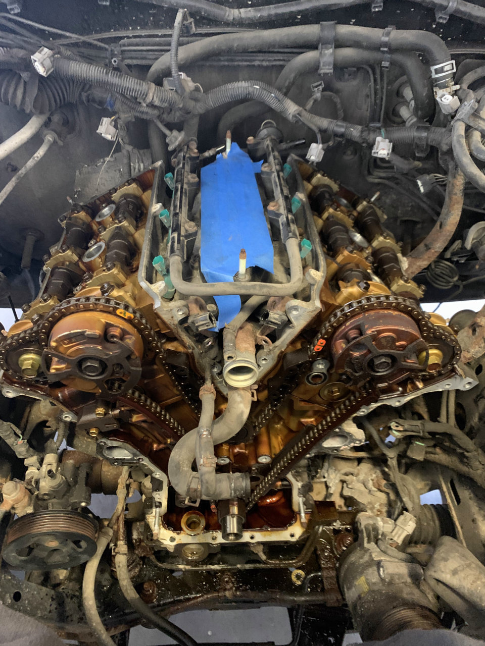

    Sadly, after 372k, my 2006 Taco needs a resurrection...
    I took my truck in to a transmission shop a couple weeks ago to diagnose something which I thought was a torque converter (had one go before, replaced tranny and tc at around 228k miles). They ended up pulling a code (despite no illumination on the dash), P0022 - ie over-retarded cam shaft. Their suggestion was to get the engine checked out, since that was most likely the culprit. I drove it to Toyota...
    Toyota said it probably was the timing chain tensioner/OCVs, and told me they thought they could open it up and repair for ~$6k, which, in this market seemed like the smart thing to do. Once they opened her up, they seemed to be scared off by the buildup of sludge and said it would be better to do a full engine swap for $14k :sadviolin:. Needless to say, I have the truck back with the engine apart and am planning on cleaning and doing the repair myself. It honestly doesn't seem all that bad, certainly not chunks of sludge like I've seen on other vehicles *ahem Ford*.
    Anyway, since this truck has become a fixer upper while I wait for my new 2021 DCLB, has anybody cleaned out an engine before? Worth it or worth doing a swap? As far as I can tell there is some slack on the timing chain, and plan to replace it along with the guides, gears and ocvs. I'm not trying to get this back to a daily driver with some "like new" engine, just for dump runs and yard work.

    replace the chains, guides, oil control valves, and the lil valve filters. Slap her back together n fuggin run her. Keep up on oil changes and she will live a long life.

    This, you could find a good recycled engine with an install kit for a lot less. Plus a little searching and you could shave a lot of miles off as well.

    Where's the sludge? The innards on that 1GR are pretty damn clean for 372k miles!!
    I've seen oil pump pickups plugged solid from sludge on other engines with a fraction of that mileage, due to neglected oil change intervals. I'd say you did a decent job of maintaining that one, personally.
    Slap a timing set in it, add in a new balancer and adjust the valves for good measure, then drive it until the frame rots out.

    Yeah, I was looking for sludge. It looks pretty good to me when you consider....

    I don't think I would ever take it back to that dealer. The tensioners don't even look that bad don't believe the engine is an issue.

    I don't see any sludge in that engine...

    I probably woulda pulled the oil control valves and cleaned the filter screens and put them back in. Truck would of probably stopped throwing the codes at that point.

    I see some varnish, but we'd need to see photos under the valve covers to see if there's actually sludge.

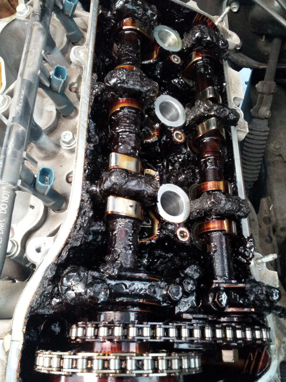

    I humbly disagree. While sludge would stick to the valve cover as well, gravity is a wonderous thing. Here's one example (albeit extreme) of a 1GR-FE that was not maintained and got sludged up as a result:

    ^^^ that makes me want to cry :rofl:

    Holy smokes that’s terrible.
    Extreme case.
    Severe neglect.

    Looks like one of the used ones that I purchased.

    Without a hot tank, or similar, you'll have a hard time breaking off or removing that burnt on oil. Minus cleaning off what you can very easily, leave it as it is. You don't want that stuff to remove itself and then clog the sump's screen.
    If you can, I highly recommend checking the sump's screen. However, that does require removing the lower oil pan. At this point, it is easy enough to do, and worthy.
    A clogged screen, will result in spun bearings. Happened on my used engine. Better safe than sorry, since you are in there.
    Also, what is your normal OCI?

    Looks like melting chocolate.
