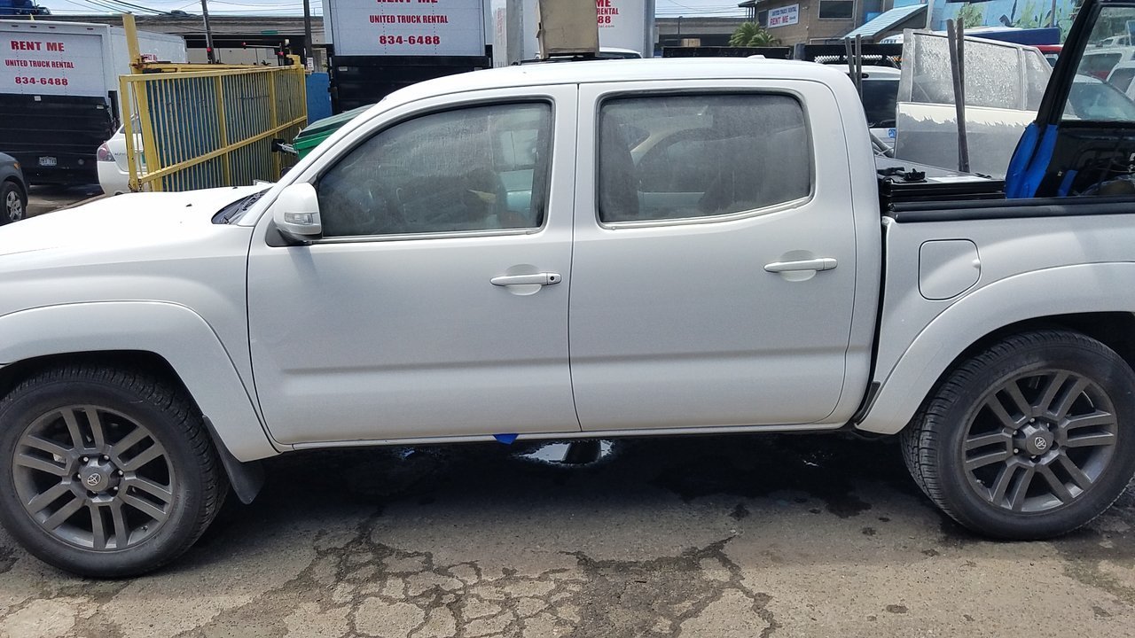

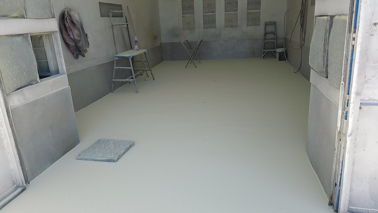

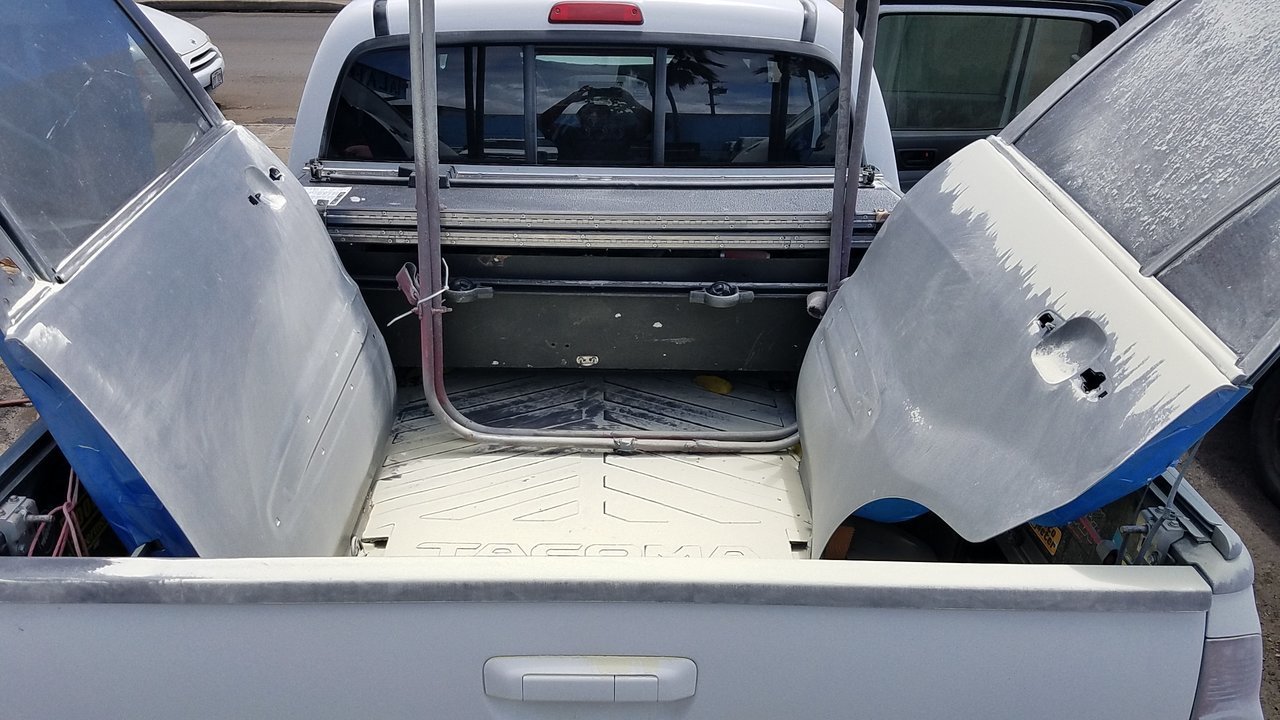

    Had little bigger mishap when rented a paint booth and lot boy pressed the fire alarm instead of compressor start . Reversed truck into paint booth and heard alarm .Then saw dark cloud coming down .Got back in drove out but powder already got in truck .Blew out interior with air then wiped down interior .
    Seems like you pretty much got it all . Lucky for you most got caught in door pocket . Maybe if you got compressor just blow out interior .
