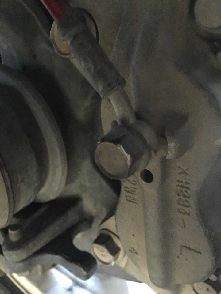

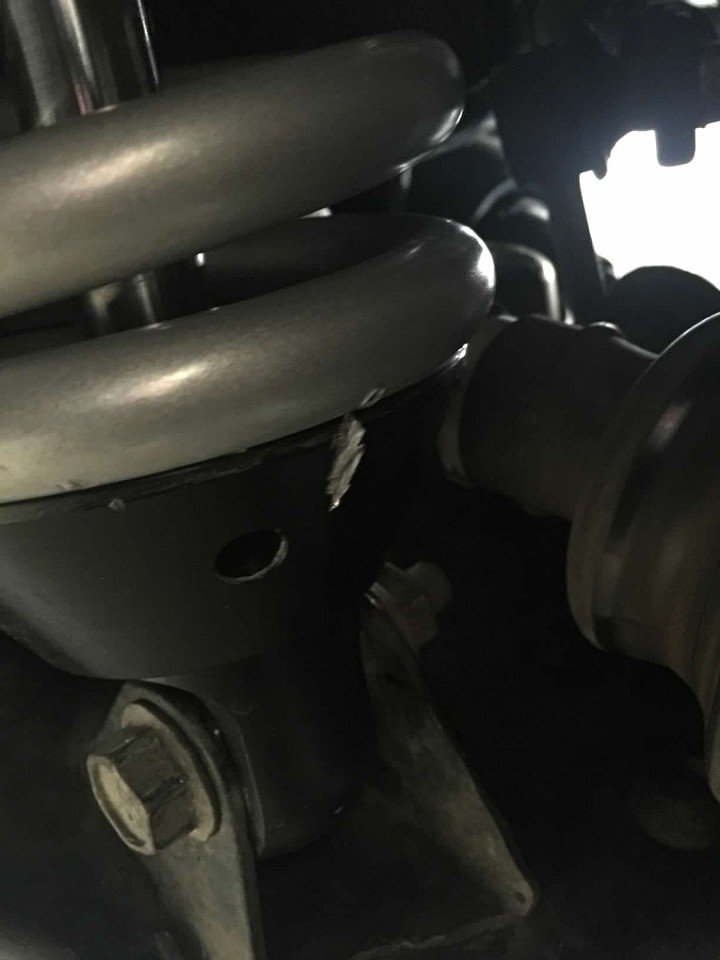

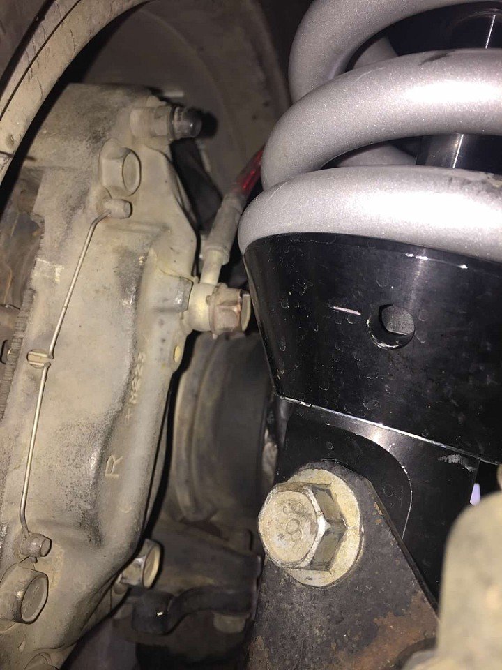

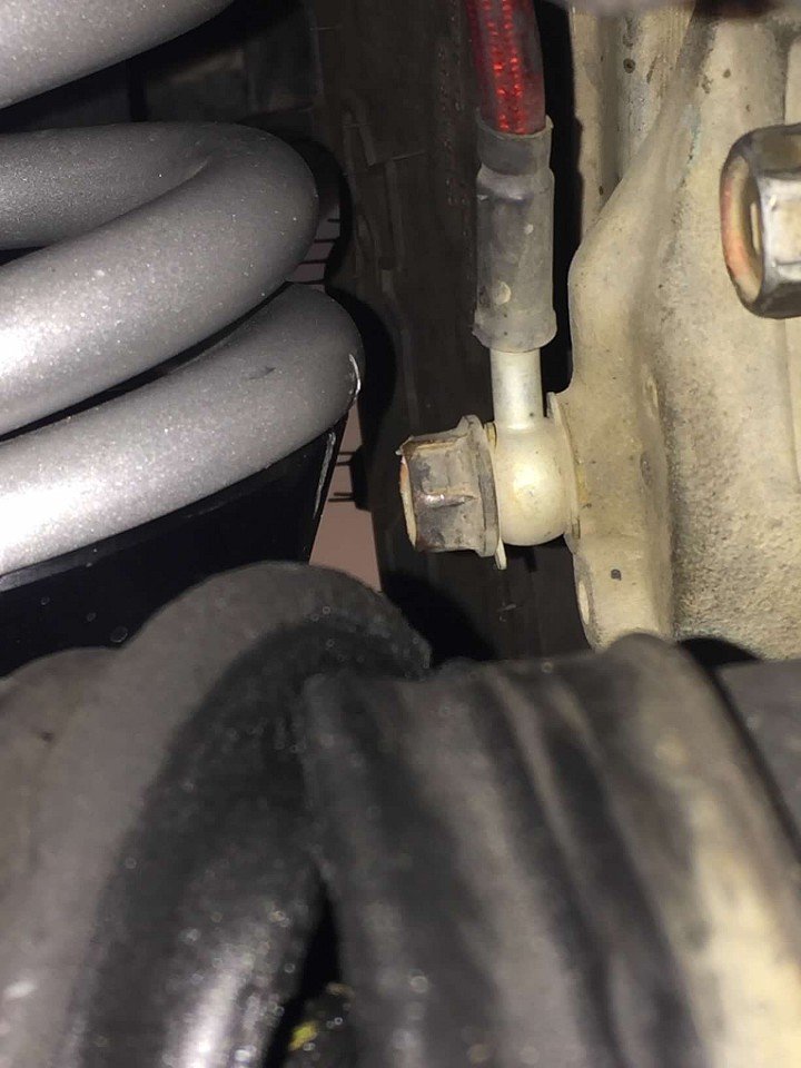

    All is well up front, except I noticed that the banjo bolt on the calipers are making contact with the shocks at full lock. Anyone have this on a 1st Gen?
    It’s badly marred.

    [​IMG][​IMG]
    [​IMG]There's a few for ya.

    Looks like it isn't spaced far enough away from the spring....are you running stock UCAs or aftermarket? Aftermarket/adjustable UCAs should give you the clearance you need to prevent that from happening

    Also, you're CV boot looks like it's torn really bad

    Common problem, You can grind the bolt head some to clear or do the Tundra brake upgrade. The aftermarket brake lines don't help as the banjo is thicker usually and spaces the bolt out more.

    That was my solution if nothing came up. Here comes the grinding... And now that you mention it I believe you to be 100% correct about the brake lines!
    Tim, thanks man!

    It's not just a Fox problem, it can happen with any 2.5 coilover on 1st gen's. My SAW's had the same issue and it would loosen the bolt on my truck. I just did the Tundra brake upgrade and it moved the banjo bolt farther away from the shock.
