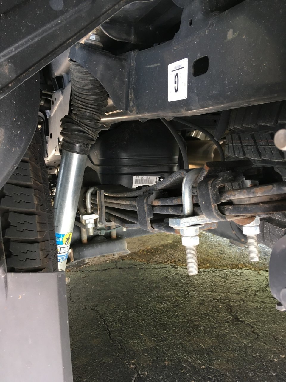

    Huh, Hellwig told me the 550’s would not fit on the 3rd gen. I think someone on this forum tried them and had to send them back, too. Did you have to modify them to work?
  18. May 23, 2018 at 11:31 AM
    #58
    mhtacoma
    mhtacoma Well-Known Member
    Dec 14, 2016
    #204829
    129
    Columbus, Ohio
    2016 DCSB MGM TRD Sport
    oops....sorry I didn't see this. They bolted right up for me. They rest against one of the stock leaf bracket straps but quite frankly it still does what it is supposed to do. I may not be getting the full resistance of the spring but I am getting enough that it is really stiff and doesn't squat at all with a dirt bike hanging off the hitch. I cranked them way down and it makes a huge difference. Again....only 50 bucks.
    I slide the shock boot down and it just works its way back up.
