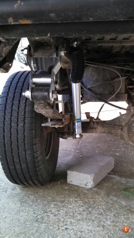

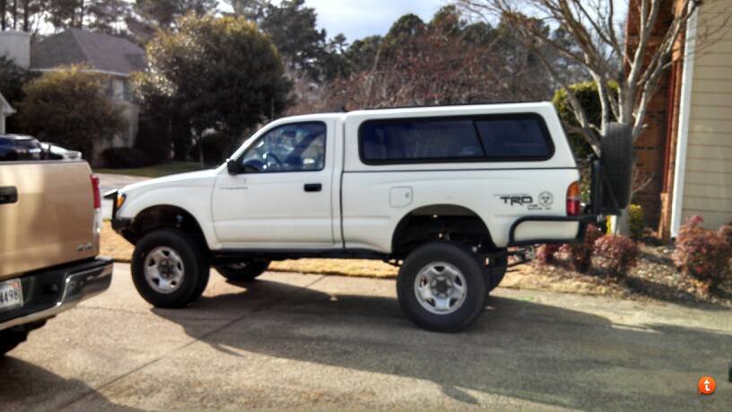

    Looks great man! That firestone lifetime is where its at! did it once and never looked back but last time I took it in I was told I have bent my passenger lca 4.5" :eek:

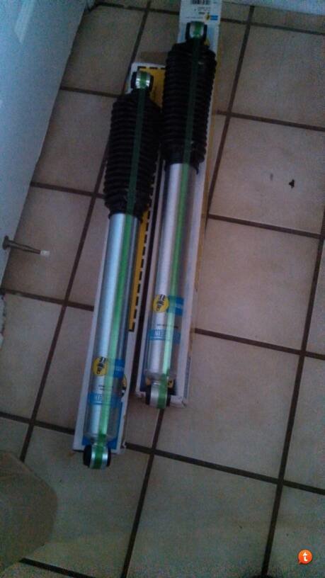

    Rear shocks are wasted due to them being about an inch and a half too short. I ordered some 5125's that are longer and a set of 1-1/4" shackles to restore the rake on the truck. Wont have them before the Land between the lakes trip, but they will be on before I go back to Windrock. I am going to send the OME 60062s back under warranty and then put them up for sale.

    Got my shocks and shackles yqu5eheb_cdfc50e56366b664f12a6385a6e9b4ff76c68262.jpg

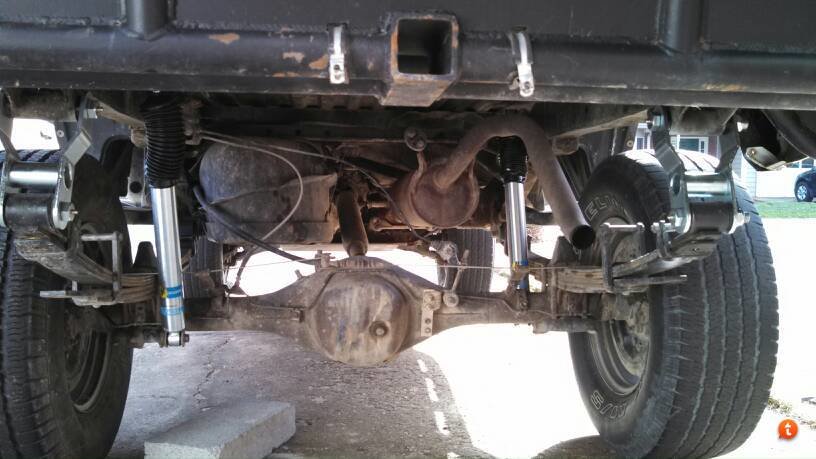

    Done for now. I might remove the overload leaf again. py7utany_e2d9c5a0c113a570005821d1c4647145a1bd3cc7.jpg
    The ride is so much smoother now.

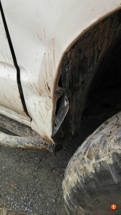

    Got a little fender damage at hurricane creek. Actually in the camping area when I was turning around. Damn tree! 9e7ype6a_de3cdb02cd0861c3cc7512e0184af1b0f2e6208c.jpg
    And Rhino chillin.

    Me and Greg watched that fender damage happen. You just said fuck it and kept on riding.

    Well it was nothing my pry bar didn't fix later. After completely striping the paint at Windrock, I'm not worried about a little dent. :)
