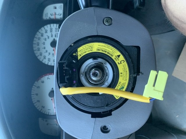

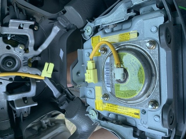

    I did it! Pretty straightforward yes. But a bit tricky getting everything off and disconnected. Didn’t take too many photos but the two I did are of the airbag being detached and after the wheel came off. Notice the little horn cord attached to the airbag!
    very easy process, but again takes a bit of patience and elbow grease getting that wheel off. Hopefully my “knock-off” part will last!
