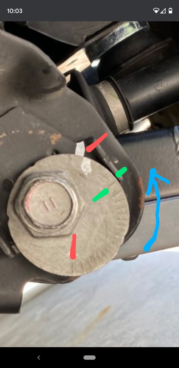

  7. Jul 12, 2020 at 9:11 PM
    #847
    CharlieCafe
    CharlieCafe Well-Known Member
    Oct 31, 2007
    #3313
    3,762
    Charles
    Wherever the wind blows
    24 Tacoma TRD Offroad Premium 4x4
    Plethora of "useless" shit
    Since all those lobes do is move the arms in and out, you should be able to rotate it to the upper side with the opposite tick mark is approx the same location on the tab at the top.
    Hopefully this shoddy illustration makes sense o_O
    Rotate up to align the red marks, which should roughly be the equivalent to the green marks in the current location

  8. Jul 12, 2020 at 9:16 PM
    #848
    hoarder23
    hoarder23 Truck fell over
    Aug 14, 2012
    #84787
    12,884
    Shay
    NJ
    15 Pyrite Mica DCSB Sport
    Scratches
    Simple enough to pull it and put in back in properly oriented.
    Mully likes this.
  9. Jul 12, 2020 at 9:25 PM

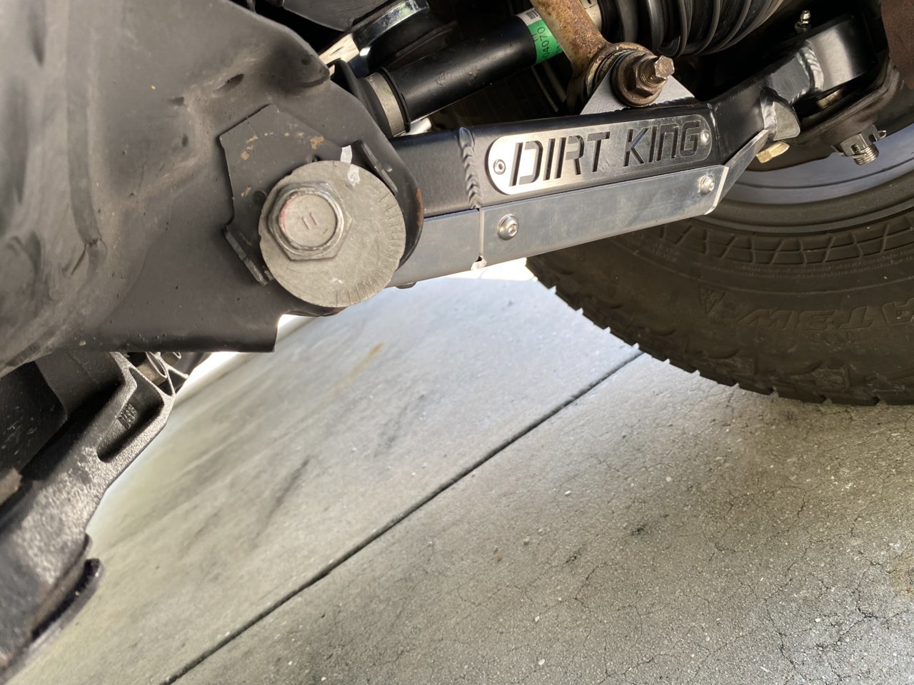

  15. Jul 13, 2020 at 11:02 AM
    #855
    patdeezy
    patdeezy Well-Known Member
    Jun 19, 2016
    #190028
    1,342
    souLcaL
    '19 OR 4x4 SuperWhite DCSB
  16. Jul 13, 2020 at 12:15 PM
    #856
    crashngiggles
    crashngiggles Tacomaworld's Resident Psych Dr.
    May 17, 2015
    #155446

  18. Jul 13, 2020 at 2:32 PM
    #858
    T@com@Steve
    T@com@Steve Well-Known Member
    Apr 14, 2015
    #153198
    1,259
    Steve
    Sarasota, Florida
    15 4x4 DCLB
    Patched headliner, loud rack, too much shit in the bed
    I can’t believe this happened brought my truck to Firestone
    1 because my other shop is closed and two Firestone has lifetime alignment which I will use again (or not)
    They literally smashed flat my cam gussets/tabs14E9D1A7-DA06-481B-A1D6-5FF57EBA6A9E.jpg
  19. Jul 13, 2020 at 2:37 PM
    #859
    hoarder23
    Aug 14, 2012
    #84787
    12,884
    Shay
    NJ
    Scratches
    That’s an expensive fix if you are paying a shop. I’d make them pay the dealer estimate for repair and then find someone good to weld in either the Total Chaos Cam tab gussets or Marlin LCA Brace.
