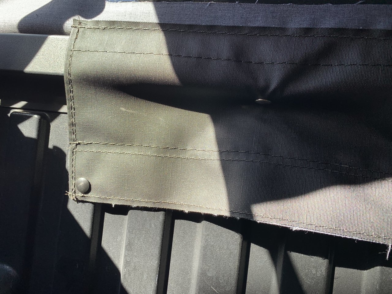

    What'd u use to seal the bed caps? Just silly cone? I added snaps today. Here's a shity Pic. You can see how much further down my snaps were. I tied into the under side of the header rail.
    tonered[QUOTED][OP] likes this.

    Very interesting. That is where I was thinking that mine would end up. I like how it pulls the front window panel back over the header. My slider still lets in the perfect amount of air when it is cold out.
    Nice work on the new snaps. :cheers: Now, I wish mine was long enough to tuck under like yours. :rofl::rofl: Big loads might crush the snaps where mine are, but they are easy to swap.
    Yes. Just exterior rated 100% silly cone plus foil tape on the rail for long term paint protection. I grabbed both at Lowes, nothing special.

    So your the tape down on the paint then silicone over the tape? I don't wanna use silicone cause I don't want the cap to stick to the rail.

    Also, the male snaps that ship with the softopper worked with the aftermarket female snaps.

    Yes. Tape first then silicone. The rails mainly sit on the paint with vertical ribs and is why I found some wear. I feel that I could peel them up if I need to down the road.
