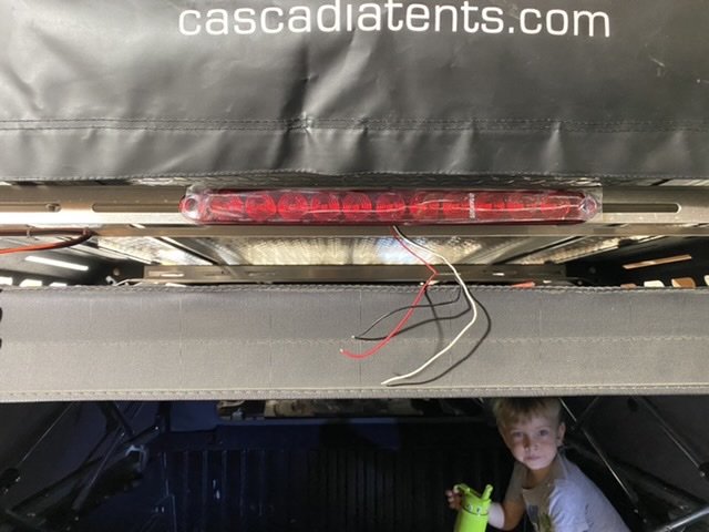

    Do you happen to know which wires on the taillight are which, I am going to do this with my rack this week?
    Thanks?
    tonered[QUOTED][OP] likes this.
  6. May 12, 2020 at 10:27 AM
    #346
    tonered
    tonered [OP] bartheloni
    Sep 25, 2017
    #231055
    31,339
    tony
    Lynnwood, WA
    So like you can see in the pic, I have the Full 'C' harnesses. The stock reverse lights are my turn signals.
    What I did was tap the Full 'C' harness just after the connection to the stock bundles. This is a really low draw LED, so there was no worry about the fuses or such.
    If you are connecting to the stock setup, I would tap the wires on the harness side. That will allow you to remove the tail lights if you need to. This pigtail cannot be easily removed through the gap in the bed unless you drill a hole. I didn't want to do that.
    For the LED, just check the connector pins for +12v across two of them. I just wedged the brake pedal down and checked the pins until I got that reading.
    If you need anything else, lemme know!

    Hat tip to a number of you sharing your third brake light mods include the pathways and parts. I have a @Dissent86 rack over my Softopper, so a little different approach for me. I still have some work to do, but finally nice to have the extra warning for people behind me.
