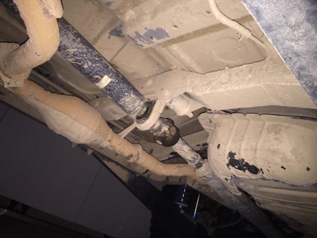

    Her is how mine is mounted. Built a whole new crossmember that the bearing is isolated on bushings. It's a little muddy from last weekend and that's my spare Timken bearing (same specs just softer) but you get the idea

    We demand better pics without the mud. Come on guys, tell @Supermoto to wash his undercarriage so we can better see his crossmember and CB assembly!

    Haha I'll try to wash it soon and get pics but it's pretty simple. And if it can survive on my truck pulling 25" of travel anyone else should be fine. Just make sure it's not too low, that will create some bad vibration.
