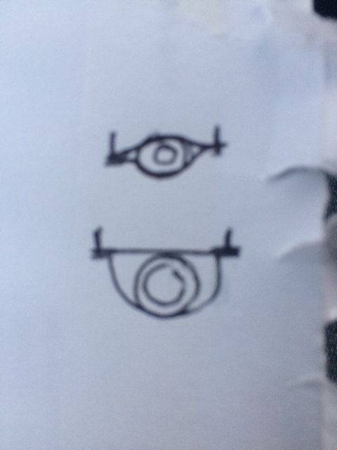

    It will be bolt up but just understand that its going to drop the driveshaft at the CB by about 1.5-2 inches or so if you use the stock mounting spot.
    If you wanted to have the driveshaft at exactly the same height it will be easier to do so on the DCSB / AC as the way the CB mount is designed you could simply mount it above where the stock one mounts. On the DCLB the CB is mounted directly below the cross member so you cant mount it above, BUT you could spin it upside down and make some standoffs to position it wherever you want vertically. That stated, OP mounted his like shown which dropped the driveshaft a lil but all of his vibes went away which is good!

    Dude I've seen you post the 1-2 inches a few times, but on my mounting area it dropped me literally almost nothing. 1/8" visually. Care to explain where you are getting the info from?

    He's taking into account where the bolt holes are in relation to the middle of the bearing.
    Here's a horrible sketch to somewhat show what I believe he means.

    Ahh!! I see what he and you are saying now. Well, even though it dropped me, it hasn't affected me much if at all. I'd like to hear @nd4spdbh 's take on correcting it if that is so the case.

    I believe in his case it benefited him to give him a straighter angle between his rear diff and tranny. I am also hoping it helps me as well since I'm currently running a DIY diff drop of about 1.5".

    Mine seemed to have retained the same angle, but seems and is are two different things. Lol.
