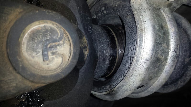

    I will call Jeff first thing in the morning and ask if there is now an extra one available. Thanks for offering your place in the GB but I can wait, I have a new OEM style CB I can install if I have to.
    I got vibes from about 7 MPH and on up. faster I go, the stronger the vibes get. Forget about driving over 62 MPH
    This is my my second OEM style CB and its just barely over a year old. I'm also on my 3rd re-tubed driveshaft. I'm not too easy on my junk while on the trail sometimes..
    I couldn't get the right angle to show the exposed bearing but you can see how bad it is...
    You rock and thanks for the offer, I have the new OEM style CB I can throw in the mean time if I have to. I don't want to take yours or anyone's place on the GB.

    Jesus!!!
    Yeah the OE carrier bearing is indefinitely a weak point in these driveshaft setups. The rest of the DS… solid.

    Mine ain't that bad, you got any drop spacers on that carrier? @MonkeyProof

    I tried spacers not too long ago, I think it made it worse so I took them off. I was going to install a new OEM style CB over the weekend until I saw this GB thread.

    Ohh alright. How much rear lift? If you install a new OEM style one I'd put some drop on it to where the driveshaft looks like a straight line basically, until you get this group buy one. Seemed to help for me, or just wait it out
