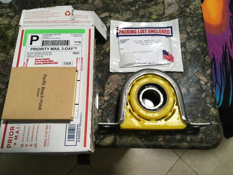

    Just got mine today.
    12TRDTacoma[OP] likes this.

    That's all there is to the order. Just the bearing itself.

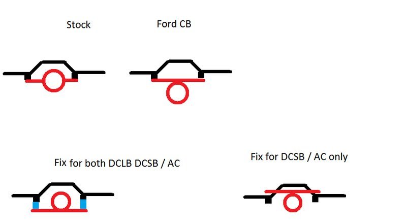

    Wow, that's night and day. Even half-assed I'm not that far off. Didn't the original post show different mounting configs depending on the applications?

    Yes, I forgot about the diagrams in the OP. Makes better sense now. I can't wait to see one of these things installed on a Short Bed.

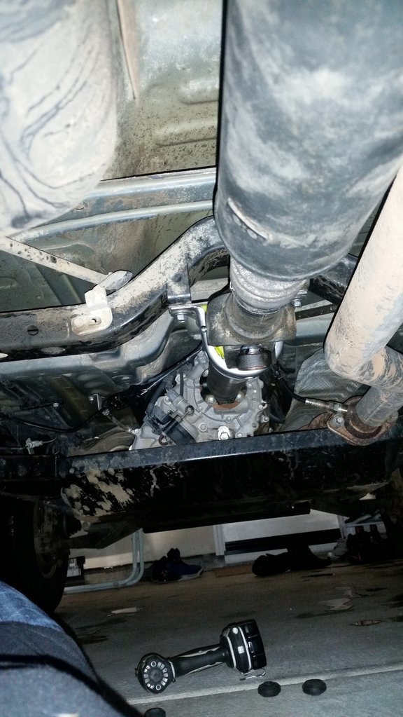

    Could you take a picture or 2 possibly of your driveshaft from one of the sides of your truck that shows the angle of your shaft? Also include how much rear lift you have approximately, thank you.

    Best shot I got. Running 2.25" overall leaf pack height in the rear.

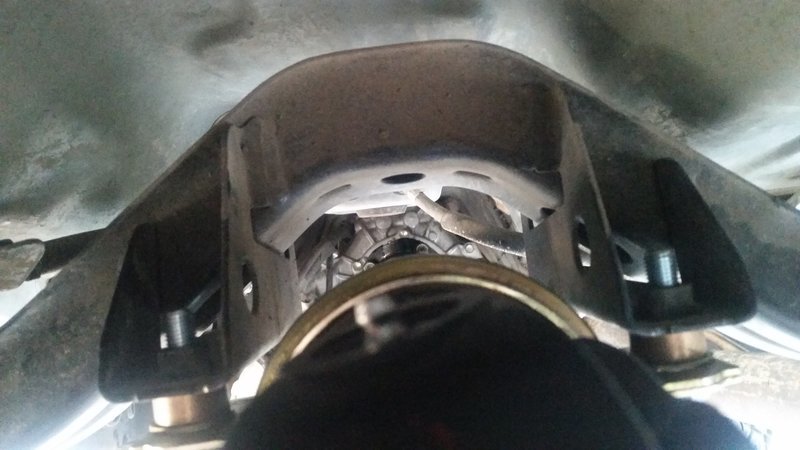

    I don't want to cause any chaos, but I don't see how these can be mounted on the top-side of the crossmember on the shortbed.
    ...and I really want one.
