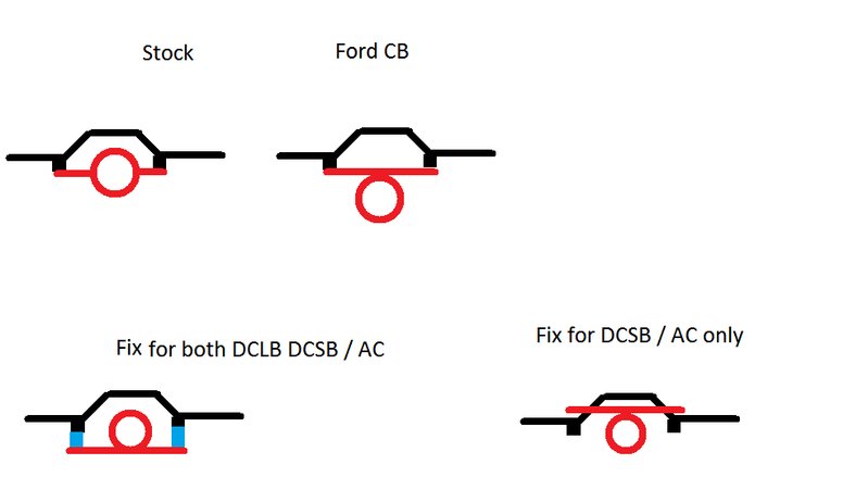

    Here is what i mean.
    You could flip the CB 180 around the axis of rotation, put some spacers in (blue) and call it good. Or in the case of the DCSB / AC that have the cb mounts that are offset from the cross member, you could mount it above where the stock CB mounts to.
    DCSB CB mount notice its offset from the centerline of the crossmember
    And the DCLB mount is directly under the crossmember
    Either way, very easy "fixes" to getting the CB back where it should be. Though the added benefit of the ford cb for those running cb drop kits is that, YOU WOULD NOT NEED EM!!!
    12TRDTacoma[OP] and MTopp like this.

    Now I just have to figure out who can put it in for me, because this is just not a couple of bolts and screws.

    It is literally just a couple bolts and screws. if you wanted your driveshaft at the same height as the stock, 2 x longer bolts, and some spacers and your good, 5 bucks in parts from the hardware store.
    12TRDTacoma[OP] likes this.

    Makes legitimate sense now that I look at it like that. Thank for clarifying man! :thumbsup:
