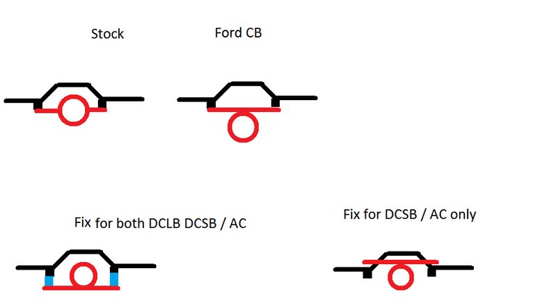

    So if I currently have my carrier bearing with the OME drop kit on it. When I install this one do I continue to use the drop kit with the new one???

    Hard to say. All applications could be different since lift options and ride height can all be different.
    Probably not since the mounting location in relation to the center of the CB is different. See below.
    IE: If you just look at the top two pictures below. They are both mounted in the same position on the frame but since the mounting location in relation to the center of the CB is different the center of the CB will be slightly lower.

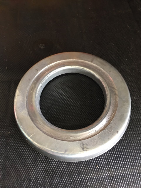

    What are those blocks made of?
    Took my setup all apart today to get rid of the unnecessary washer and replace the flange nut 15/16"
    Took an hour :)
    Meanwhile here is the grinding and rattling damage to the washer:
