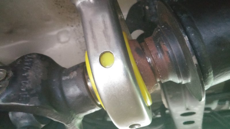

    I uploaded two pics showing the gaps that I'm left with on both sides of the bearing. It seems like my 2014 DCSB has a different drive shaft than older models.
    The metal caps you see up against the bearing are the OEM caps from the original bearing. The problem is that they are loose, and can be moved back and forth with my fingers.
    I haven't had a chance yet to take it for a drive, so I don't know how well it's going to work. I believe that I'm going to have to take it back apart and fab some spacers for the front and rear to keep the dust shields in place though.

    We have covered the dust caps in this thread. That bearing is sealed and no need for the dust caps.

    So just take them off entirely?
    nfs257[QUOTED] likes this.

    That's good to know, thanks. I admittedly didn't read but part of this thread. I appreciate the info.

    Yeah. Mine are already off due to the bearing I've been running. Not needed if sealed.
