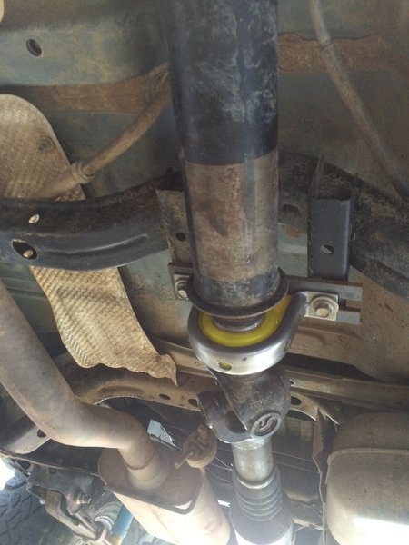

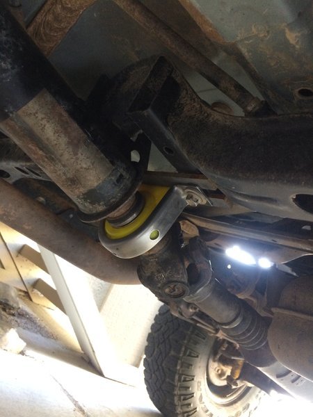

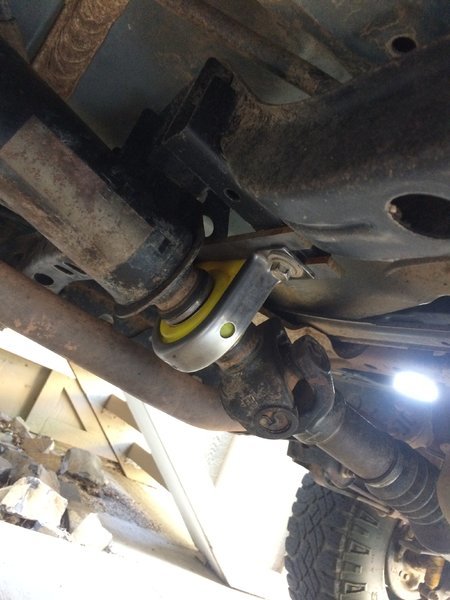

    So I had gnarly vibes during take off, and at pretty much all ranges of speed. I replaced the CB with a new OEM CB about a year ago and it was already trashed. I looked up solutions to the extreme wear on the part and found this thread. Everyone seemed to have generally positive reviews so I took the part to a shop and had them put it on.
    Results:
    Vibes during takeoff - eliminated
    vibes at high speed (60mph - 90mph) - eliminated
    vibes during deceleration - moderate
    Problem* Vibes from 32mph - 45mph - The vibes are so harsh they shake the entire truck.
    Overall I think I'm happy because this part should last longer than the stock rubber CB. However once this bearing goes out I will be making the transition to a single shaft to eliminate the carrier bearing all together.
