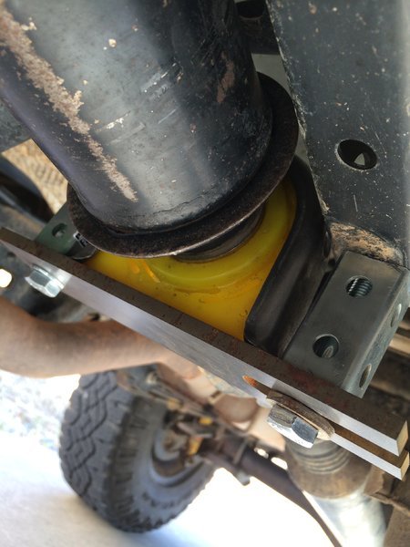

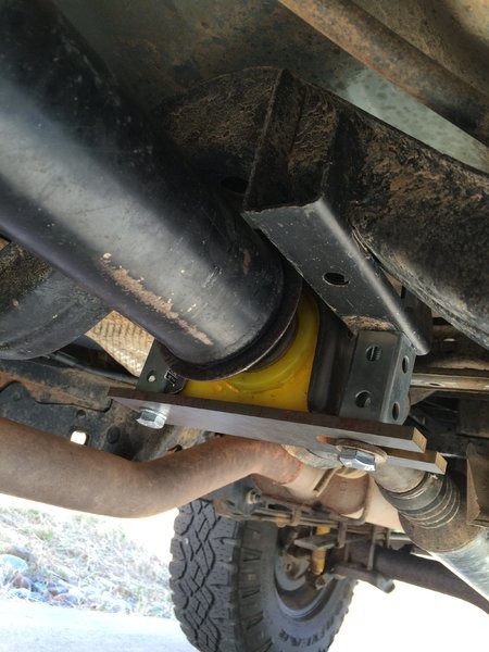

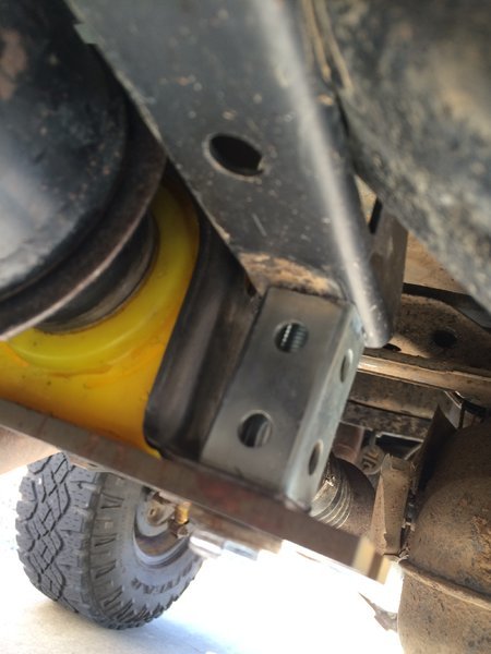

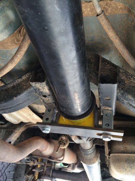

    Ok! Over the weekend I drove back to my hometown, and too my circular saw. Home Depot didn't have the correct tubing, so I picked up some temporary tubing until I find the correct size for the blocks and the right tubing. My previous post in this thread was a total lie. I hadn't driven long enough on a smooth road to figure out that I had bad vibrations at virtually every mph. So I went ahead and flipped it around and put 2 1/8th inch blocks in it. This still has vibrations at 11-20 and 30-35, but this is way better than 30 - 80 mph vibes. I know there is a sweet spot somewhere in there and I'll let you guys know what it is when I find it in a couple weekends. IMG_3256.jpgIMG_3258.jpgIMG_3257.jpgIMG_3259.jpg
    Add on: Yes I am aware how ugly my setup is currently :lalala:
