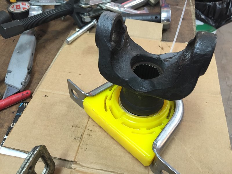

    The 12 - 15 Tacomas appear to have a different driveshaft. Mine fit so poorly when I installed it, I ended up taking it off and reinstalling the OEM bearing.

    Don't know what to tell you abiut that. Mine fit just fine and we are both 12-15.

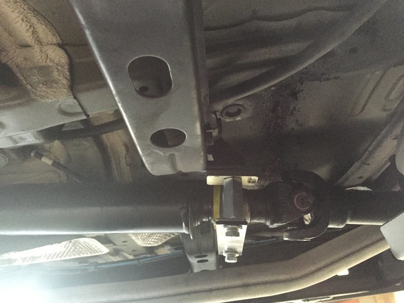

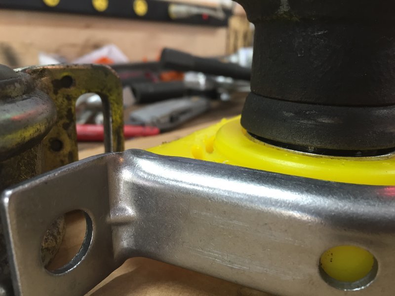

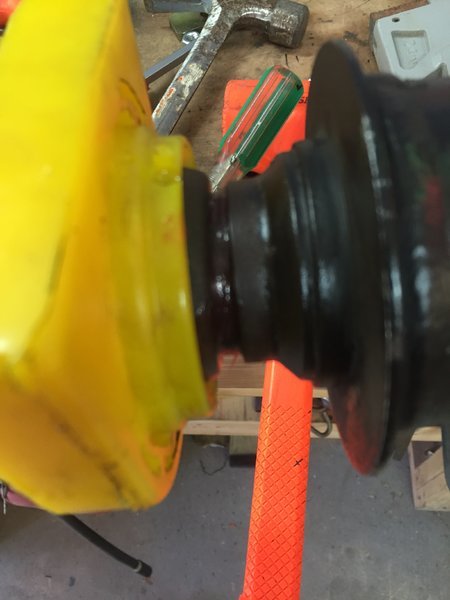

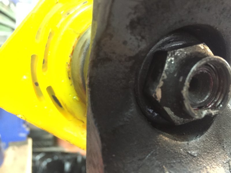

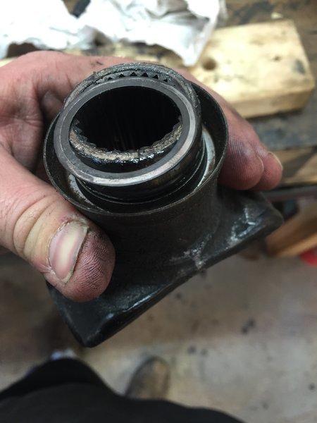

    I believe Everything is seated. Did you guys end up with these gaps, and did you get the nut on further than I did?

    That's exactly how mine sat on my 2014. That's why I went back to stock.

    OK. The bearing is sealed so the dust caps don't really matter. The nut I put licktite and restaked it. I was more concerned that everything is seated.

    IT'S NORMAL.
    There was no need to go back to stock, as the way it was sitting on yours and his is normal.
    You are good man. No dust caps required. Enjoy your new bearing!

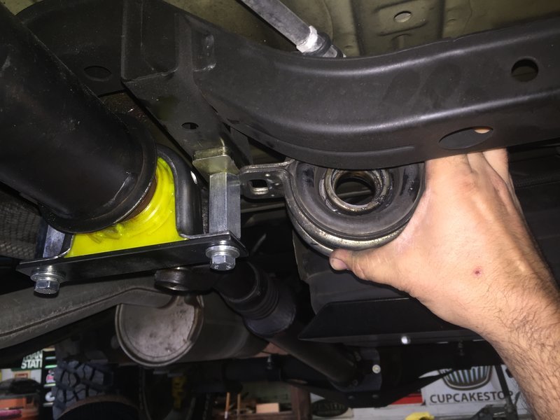

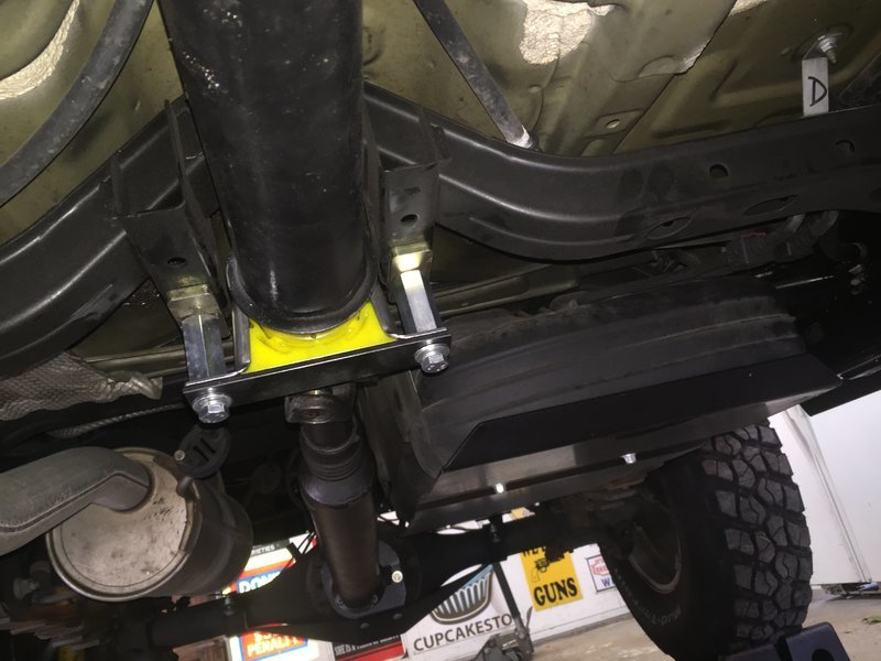

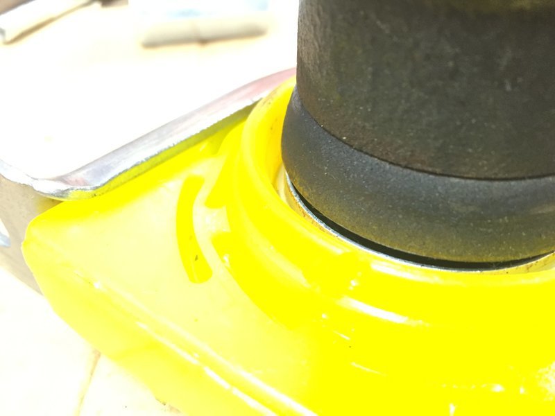

    Alright, another successful DCSB install :thumbsup:

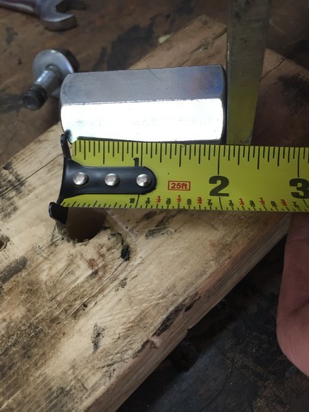

    Home Depot didn't have any 1" steel square tubing so I started looking for other options for spacers.
    These threaded connectors for joining threaded rod together were right next to the steel section. I figured I could cut these down to work as spacers.
    I got lucky though. These spacers in conjunction with the drop spacers I'd already had installed put the new bearing in the exact same spot as the factory one. Since I didn't have s problem with vibes this was good.
    And the finished product:
    Side note. First time I've seen one of these ridiculous Moog flat grease fittings. Some things just do not need to be "improved"...

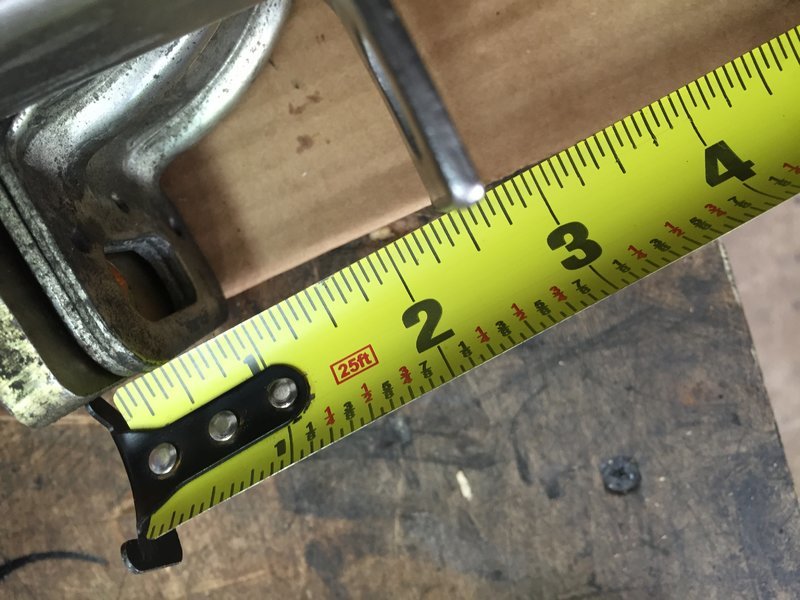

    How large were those bolts you got for it? mm wise, and how thick were those flat spacers you put the threaded couplers over?
    That was actually an option I was exploring when it came to flipping the CB.

    The couplers were for 5/8 threaded rod. I believe the flat spacers are 3/8 thick. I'd have to measure again.
