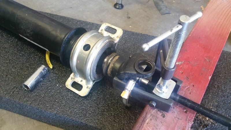

    Do one at a time, Pull the yoke off first (MAKE SURE TO MAKE ITS ORIENTATION).
    Then you should be able to push off the outter rubber from the actual bearing on the drive shaft, then pull the bearing off in the same mannor as the yoke.

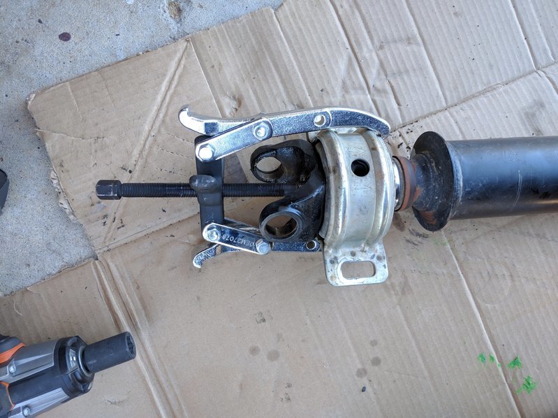

    I pulled like this.

    I see what you did there! Cool! I'll try that. Thanks. How hard did you have to pull? Mine seems well pressed. Lol hope the oil helps.

    It's fairly tight, but once it starts moving it'll be easy.

    I think I had to use my foot to break it.

    Thanks Sam. I tried again, and the puller the I have can't get grip in that orientation. Might have to get a different puller or do something else... Thanks.

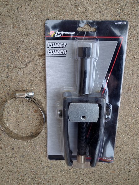

    I had to use a big hose clamp to hold the jaws in position.

    pull via the spots for the end caps of the u joint

    I thought of that, but that may damage or score the metal.
    Is that how you did yours?

    Mine came off with such little effort i was able to get away with grabbing it out with samiam's method above.
    But if it was being a pest i wouldnt have and issue grabbing it from the cap holes. If i really wanted to be nice id wrap the ends of the jaws with some electrical tape or slide a bit of rubber hose over the end of the jaws.
