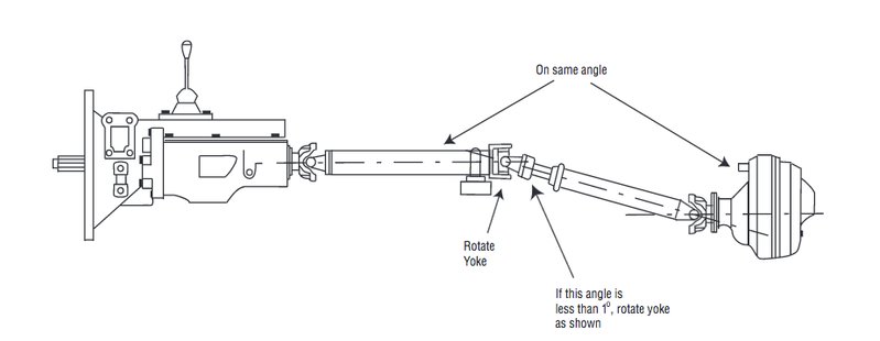

    You might want to do some fact checking.
    Spicer says to make the pinon angle match the slope of the first shaft.
    I snipped this picture out of their documentation.
    My pinion is -2* from fist shaft and I have no unwanted vibrations other than initial take off shudder.
    All my u-joints were in spec except for the fist one which is 5.05*.
    I'm currently waiting on a stock CSB replacement to be delivered...
    ChadsPride and DrFunker like this.

  16. Sep 15, 2016 at 2:27 AM
    #1156
    DrFunker
    DrFunker Well-Known Member
    Feb 3, 2014
    #122158
    42,919
    I can't see the picture that @Crom posted above. But I think this is the one he is talking about.Screen Shot 2016-09-15 at 5.25.57 AM.jpg
    ChadsPride likes this.
  17. Sep 15, 2016 at 6:20 AM
    #1157
    MTopp
    MTopp Professional bear handler
    Aug 12, 2013
    #110295
    5,811
    05 SR5 4x4
    trifecta tonneau, pop n' lock, Depo black bezel headlights, mb 352 wheels, 265/75r16 cooper at3s, visors, colormatched 2011 grille with raptor LEDs, much LEDs in and out Future/wanted: black valence, hood scoop, catback, CAI, 285/75r16s, OMD leaf pack mod
    There's multiple setups/ways to do it. That's one of them from spicer, I've seen that one.

    Yeah a million ways to do it wrong. And one a right way. :p
    It's geometry.
    Spicer states that pinion should match slope of first shaft, not the TC as you indicated.
    Right out of the Spicer install manual page 16-17.
    • For a 2-shaft application, set up the first coupling shaft (sometimes called a jackshaft) so that the universal joint operating angle that occurs at the transmission end is 1 to 1-1/2 degrees.
    • Install or tilt the axle so it is mounted on the same angle as the first coupling shaft (the centerlines of the axle and the first coupling shaft will be parallel)
    Spicer further states that, BY FOLLOWING THIS PROCEDURE, THE UNIVERSAL JOINT OPERATING ANGLE AT EACH END OF THE LAST SHAFT WILL AUTOMATICALLY BE EQUAL.
    That illustration refers to compensating for an exception. Here is the accompanying text
    Check the actual universal joint operating angle at the rear of the first coupling shaft. If it is less than 1º and the transmission universal joint operating angle is greater than 1.5º, rotate the end yoke at the center bearing position so that the ears of the yoke are 90º to the ears of the tube yoke on the transmission end of the coupling shaft. As an alternative, rotate the slip yoke on the driveshaft 90º if the slip spline has 16 teeth
    And just to be clear, I'm only posting this because misinformation, when posted many times over, can be very hard to correct.
    Personally for me, I'll have my DS rebuilt in a week with OEM CSB and will reinstall. I'll attempt to follow Spicers direction (if possible), and see how it plays out. Luckily for me I have a DS expert that I can persuade to assist me if I run into any issues.
