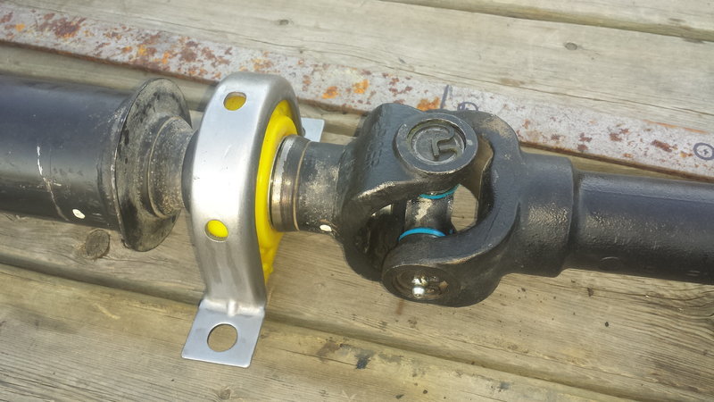

    Also super worried about the angles with this thing. I don't think my truck is lifted enough to be able to run this thing top plate up. I'm going to have to fiddle with spacers and nonsense. That just makes me want to rage already

    Yes it's directional. I think you're over-thinking it tbh. You can always try just a regular carrier bearing first I guess.. See if that eliminates the issue.

    As XPOTRPR said, it's directional. Also, if you search the thread (or I will and will quote it for you) all the info for what you need is there. The IEDLS with the smallest possible spacer will put the driveshaft at wherever it is now - assuming you don't have a CB drop kit or have flipped the CB 180*
    Edit: see the below posts I quoted

    Here he says 1" made the driveshaft contact the subframe, I believe I tried 1.125" or 1.25" at some point and it worked, so either try 1.125" or 1.25" first then go from there.
    @AR15xAR10 Pertinent information below (Thanks to @MonkeyProof )

    But i got mine from another member and i don't see any markings on it.....
    Obviously i have tubing and can make spacers but i really do not want to fuck with it. I may just keep this until i do dakars/ucas/coilovers

    Look at your carrier, the physical attributes. Then look at the pictures in them quotes I pulled for you. Install it exactly like that lol
