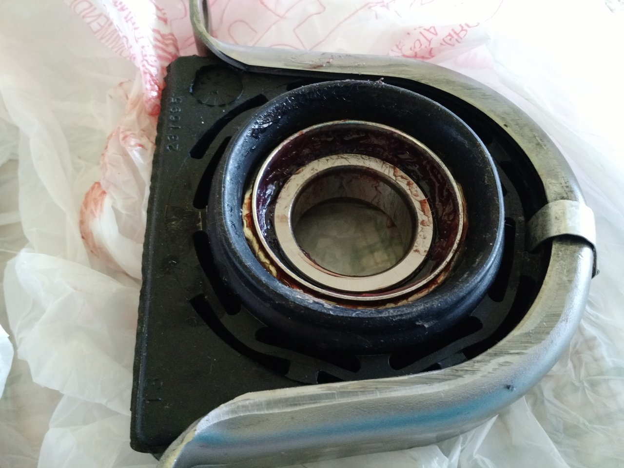

    Ok from what I gather after reading pages and pages on this thread. Is that for a DCSB you have to set up the CB “flipped” , make spacers , fab a top plate and use longer bolts correct ? I have the newer Dakar leaf springs (96R) that give 2.75” of lift. Or should I just go ahead and install the “regular” way with just the top retaining plate ?
    Also from the looks of the spicer CB above in the pic (black rubber ) it might be a happy medium between the slop ass factory one and the poly one (yellow) not to mention it’s only $27 vs. $125 might be worth a shot. TIA

    I ordered the new spicer ( black rubber ) ford CB. Install still follows same as the poly one correct on a DCSB ?
