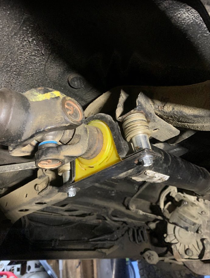

    The crazy thing is that I replaced my original one yesterday, and I was thinking that this thread was going to be buried and hard to find for the update..
    Originally, 8 years ago I missed getting the IEDS Carrier Bearing through the group buy by a day or two. So I went in person to get one at the IEDS shop, they still honored me the group buy discount when I went to pay.
    fast forward 8 years later....Last week I go in person to purchase another one, I was still in the system with notes from the original visit and got the Group Buy discount price again!!! Can't beat that kind of customer service!!
    It was time for a new one.. after 8 years the actual center bearing had separated from the polyurethane..
    The new one looking so fresh before the install..
    Installed with fresh U-joints..
    Installed with a fresh new nut with some Red Lock-Tite applied and torqued to spec found in the WSM
    Not looking so good.. but 8 years of service compared to the OEM center bearing that I was going through often at the time. The bearing itself still spins freely
    Ready for another 8 years of abuse!!

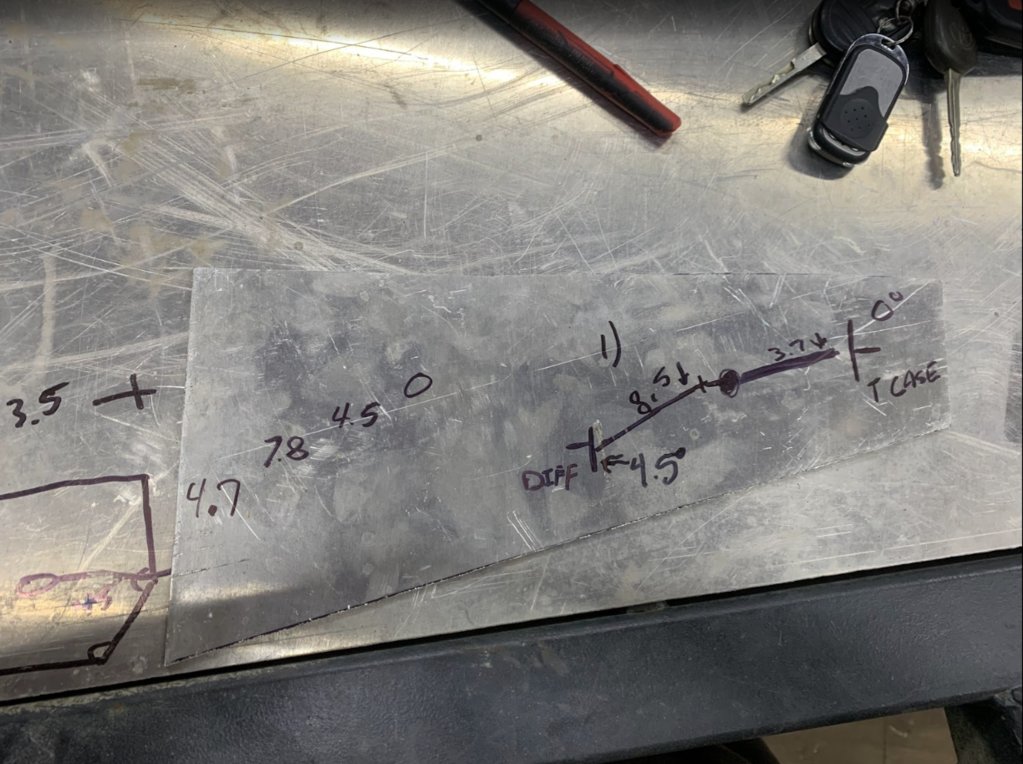

  16. Aug 27, 2025 at 7:09 AM
    #1536
    TacoTuesday603
    TacoTuesday603 I welded it helded
    May 3, 2021
    #364592
    3,530
    Jack
    New Hampshire
    2011 OR DCFB
    Fox and Locked suspension 63's Skinny 33's
    I installed this CB and have been trying to figure out some vibes. What do people shoot for for driveline angles.
    Ive seen two different ways.
    1. Make 1 st shaft out of the tcase within a degree of the tcase output, then make 2nd ujoint and 3rd ujoint working angles equal.
    2. Ignore 1st working angle 4-5 degrees is fine, Make pinion angle equal to fist working angle.
    Drainbung likes this.
  17. Aug 28, 2025 at 4:08 AM
    #1537
    TacoTuesday603
    May 3, 2021
    #364592
    3,530
    Jack
    New Hampshire
    2011 OR DCFB
    No luck with method 2. Got pinion angle parallel to 1st shaft and still vibrated.
    Took out the driveshaft and drove in FWD. No vibes at all.
    @MonkeyProof what did you shoot for for angles?

    Well I suck math...so I went with the how it feels in the seat method
  19. Aug 28, 2025 at 8:40 AM
    #1539
    JdevTac
    JdevTac Well-Known Member
    Jan 8, 2012
    #70234
    6,331
    Josh
    MD/GA
    2nd gen
    When I ran a Ranger bearing I used method 1. Still took some shimming of the center support bearing mounts to dial it in to real world best feel. Ended up with a minor transient vibe around 30mph and vibes starting at 80mph. Adjusting the rear pinion angle down some on my setup made it a little better.
