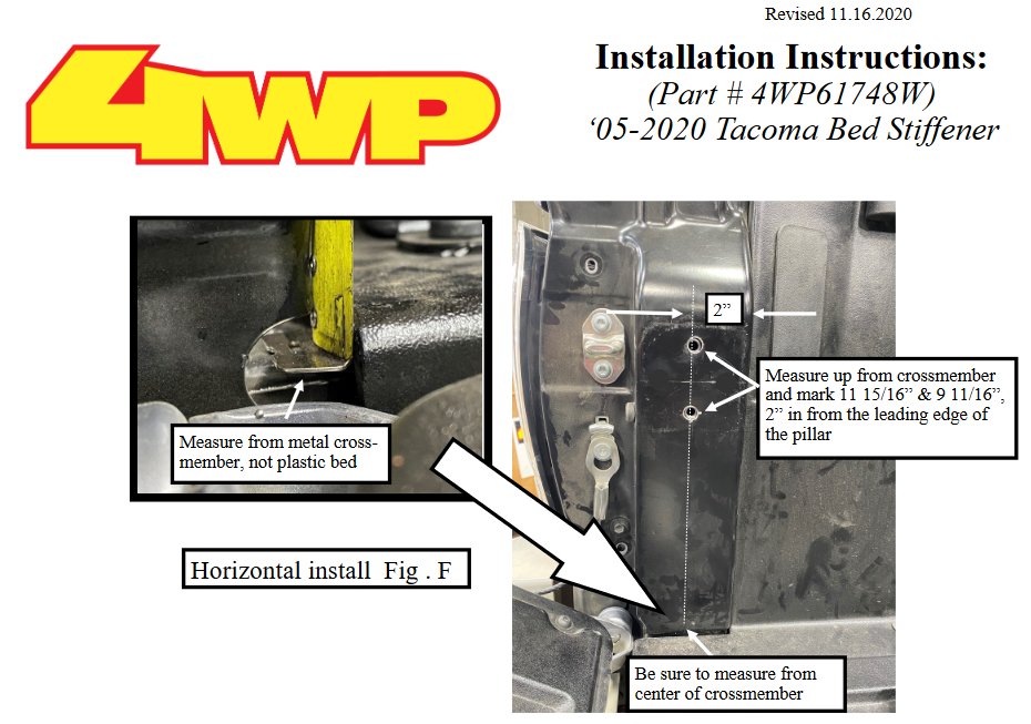

    What's the spacing you have in your file?
    I'm using 2.25" between the holes.

    Whelp, that's part of it, I built this version in AutoCAD from the early drawing that was posted. It has 2.2205 as the spacing.
    I should have checked that, I KNEW that dimension.

    Yeah forgot to mention that; not sure why the originally posted drawing has an odd hole spacing since even 4WP lists a 2.25 spacing for their install.
    11.9375 - 9.6875 = 2.25

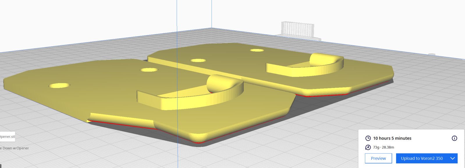

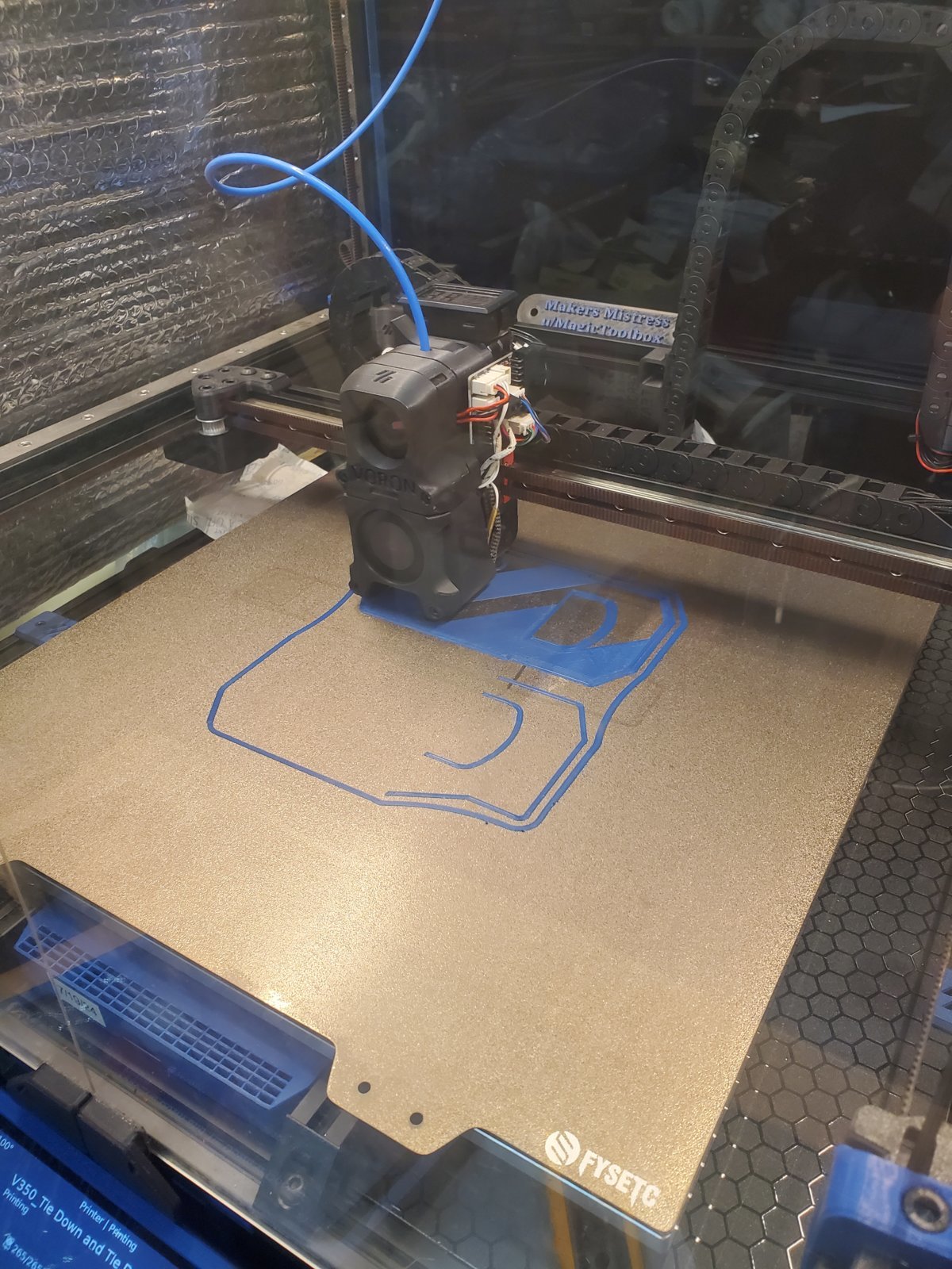

    Many thanks @Kwikvette , I now have plastic spacers printing that use your CAD as a starting point. Cura slicer (what I use for printing CAM) tells me they will be 10 hrs printing, I guess I need to start tuning for speed if I'm going to be knocking these out.
    The bottle opener version has an exposed "tooth" for bottle caps. I think laminating it with plastic would make it more difficult to use - I call it a tooth because it has the ability to bite! Be careful in the corner of the bed where that is installed!
    I'm printing this pair in blue so it is easier to photograph. I don't think we want to get into color options for the spacers though, keeping track of tie downs and F-Bombs is a lot already.

    That 3D printer has seen many things :crapstorm:
