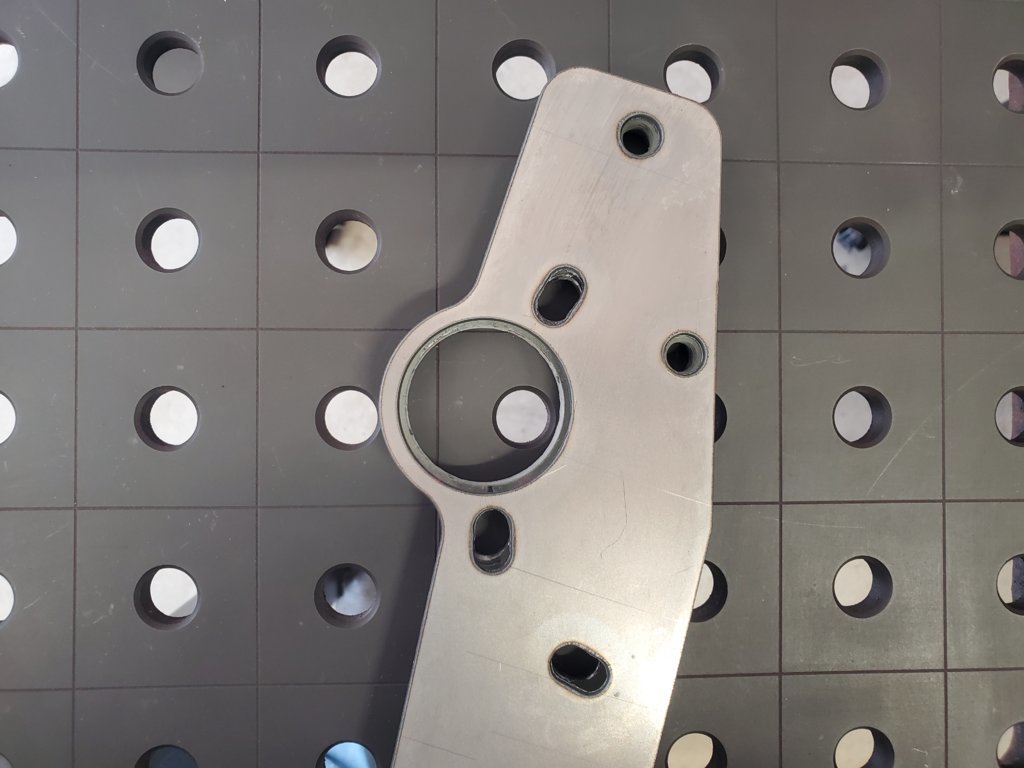

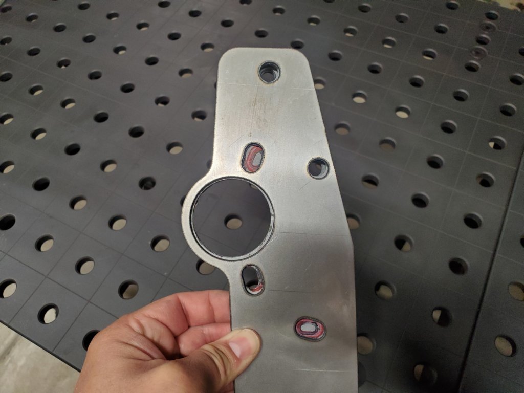

    Would you say this is "good enough" ?
    Only looks a little off since it's "floating" above your bracket, but also because I made the hole larger by 0.2"
    Although your other one has the slot marked slightly offset compared to the first one.

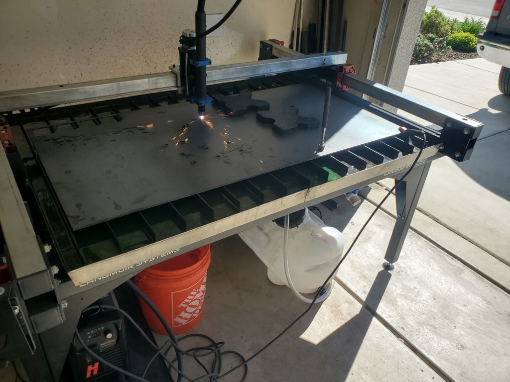

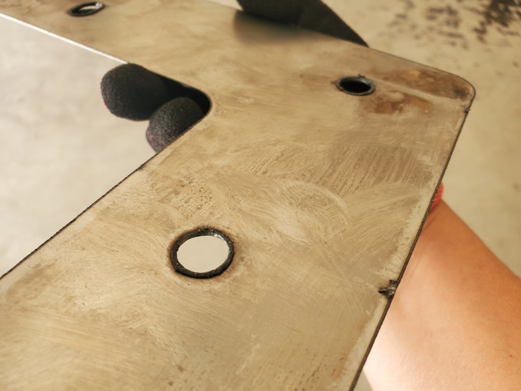

    My old speed for cutting 16 gauge was 110ipm. This was done at 249ipm and the rear came out with far less dross even.

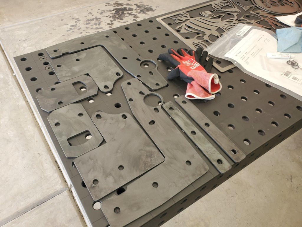

    After cutting another 4-5 small test pieces, I ran with the file to cut a single set out.
    Came out as expected :cool:

    I will be bending and welding this set up this weekend, and look to buying more steel later in the week to fulfill more orders.
    We're back in business :cool:

    It “looks” good. You could also compare to the paper template as well. The ovals only help use the cable management clips. The oversize allows the clip to grasp the original panel by expanding on the backside (thus the oversize). Once I have them back, they’ll be ready to install and I can let you know. Things were so close to begin with, the clip cuts were more of a finishing touch. I just wish my drill press didn’t have so much walk. I miss having oxy/acetylene (won’t even dream plasma).

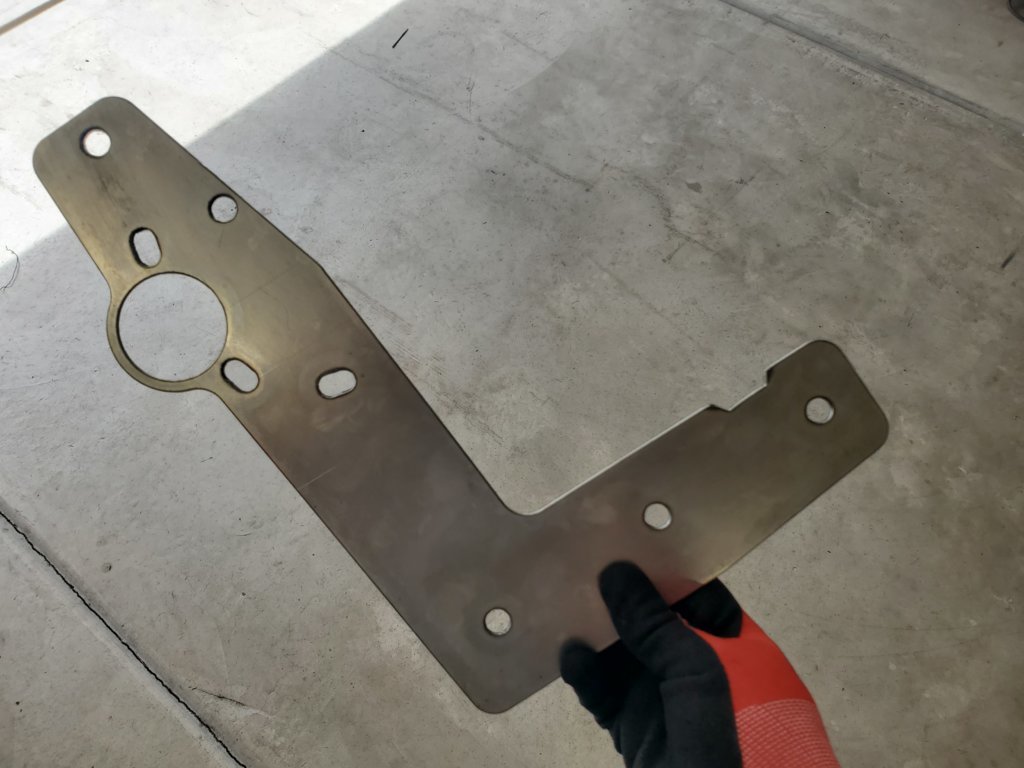

    You'll notice the slots do seem a bit oversized in my revised parts.
    My only gripe now is that the hole on the L bracket seems really close to the edge. I'll simply need to ensure I bolt on the hardware with the nut even with the edge prior to welding it on.

    I did use the template you sent, still got it.
    And it lines up well, but then it doesn't if you angle it the slightest.
    Like I mentioned I matched it up on one set you drilled out, but it's slightly offset on the second.
    Though I believe this works anyway due to the slotted holes on the internal bracket which allows for adjustment.
