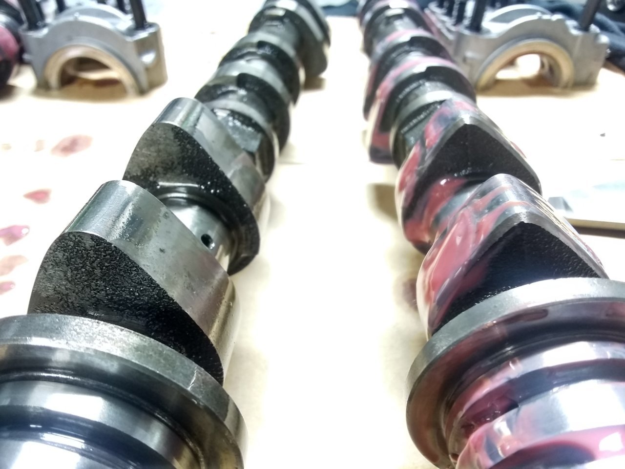

    That is the OEM intake cam. Where I stopped, after checking lash on each lobe. Needs buckets swapped on 5, to tighten them up.

    I thought the lobes looked a little thin/pointy..
    Any chance you can get a side-by-side with your Kelfords ;)

    @JustDSM
    Kelford intake versus OEM intake.
