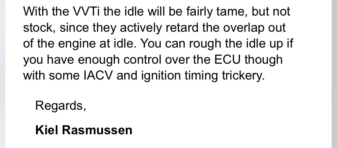

    He just replied and had this to say:
    Can someone comment on how much IACV control we have? Still a hptuner noob

    I’m going to go ahead and say that you need hptuners. No ifs ands or buts. The o2 feedback isn’t going to do anything to your mapping in open loop. It has to be tuned right. I and everyone else here will tell ya; the ability to tweak things to your particular setup is likely the best “mod” you’ll do to this truck.
    Yes you need bigger injectors @ 2.7” or smaller pulley. Most of us bought 650’s. I think I heard hubbub of another group buy on those.

    You want that nasty cam idle. I know.
    Yes, you can advance the intake cams wherever you want. I’ve played with it some. Idle speeds are more about targets and adders.
    Get the cams in and tuned to make the power. You can futz with it to make it idle like a sportster later.

    We dont have iacv.
