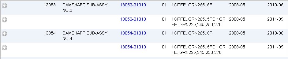

    Kiel isnt certain a 2015 has the correct internals for these cams. Can anyone confirm this?

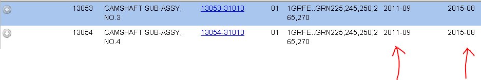

    He thinks 2010 was the last year. I'll show him this. Thank you.

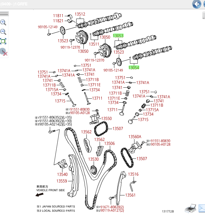

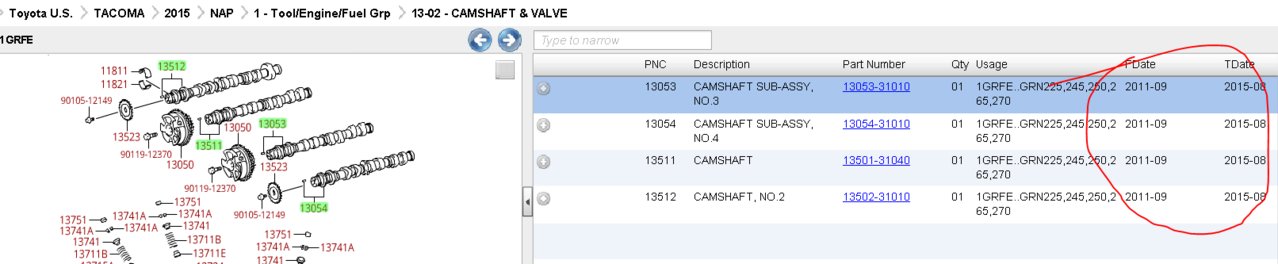

    This might be better to show him. These are the LH cams. Same numbers for 05-15

    I'll send him this. He just seemed very cautious about it. He will make my order if I ask. But if it doesn't work out its mine to keep. If it's the 4runner motor that's different maybe we can check part #s to make sure they're different. He suggested popping a valve cover and sending a pic but I'm not at a point to do that.
