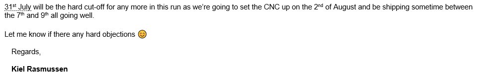

    When does he start grinding?
  4. Jul 30, 2019 at 6:14 AM
    #784
    Torspd
    Torspd Tor-nication
    Sep 18, 2009
    #22958
    26,446
    Tor
    The Great America!
    MMVI 4.4L 4x4 Access Cab
    Torspd Custom Turbo kit [] Borg Warner 9180EFR Turbo [] Haltech Elite 2500 [] TiAL Q BOV [] TiAL V44 Wastegate @ 15psi [] CP Pistons [] CP Carrillo Rods [] ARP Head studs [] ARP Main Studs [] ARP Header - Head Studs [] Ported Heads w/ 1mm oversized valves intake/exhaust [] Brian Crower Forged Stroker Crank [] Darton M.I.D. Sleeved Block [] Kelford Camshafts [] Torspd 160* T-stat mod [] APR Large Fuel Rail [] Walbro 460 LPH E85 Fuel Pump [] FueLab FPR [] APR T56 Conversion Kit [] KP RACING Built T56 [] McLeod Racing Custom Twin Disk Clutch [] One Piece Aluminum Driveshaft [] MGW Shifter [] Custom lowering kit [] Ohlins Front Coilovers [] QA1rear shocks [] Custom Ron Davis Radiator [] Dual SPAL Electric Fans []
    Thursday is the day.

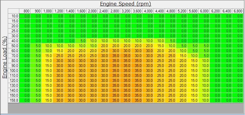

    It doesn't "switch", it's a continuously variable system based on RPM/Load.
    Below is the stock TRD VVTi map:

    Most of us have probably seen this valve timing diagram attached, but here it is. Combined with the chart that @JustDSM posted, it gives you an idea where and how much valve overlap there is.
