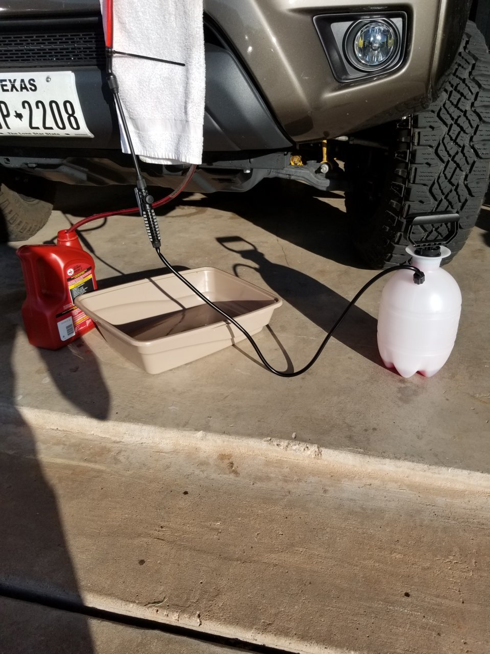

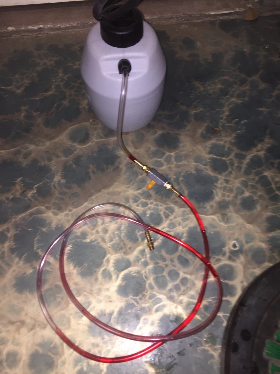

    Just for the record, I did end up using the oil pressure sender port for priming the system for my replacement engine startup. Worked amazingly! Just used a CHEAP 1 gallon sprayer, some acrylic hose, a small ball valve, and 1/8"npt adapter for the block. (all in about $30-35 bucks) I'll see if I can post a pic later.
    I added about three quarts right before startup and distributed it in the engine. Oil priming made easy!
    Since then, I've also cleaned it out and used it to add transmission fluid during a valve body change. Game changer for that application. It's soooooo easy. A few pumps and you let the sprayer send in all the fluid.

    Something like this? :D

    Damn, did you get your cams in already?
    J/k. Looks like tranny flush time.

    Just remember, that oil sensor thread is actually 1/8 BSPT. Just different enough from NPT.

    Yes, this is correct!

    Now with picture:
