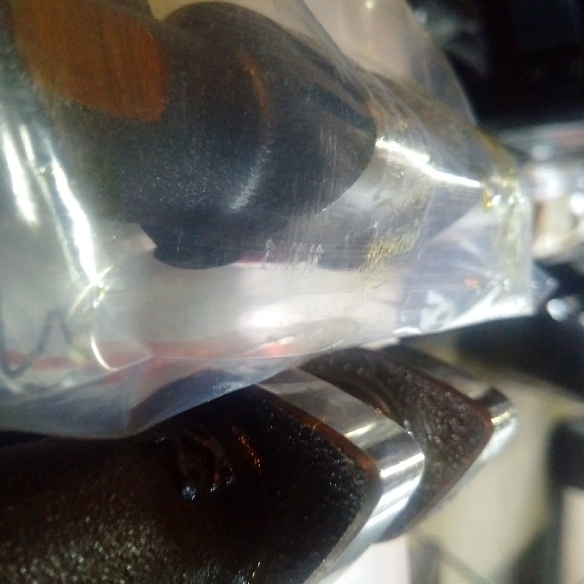

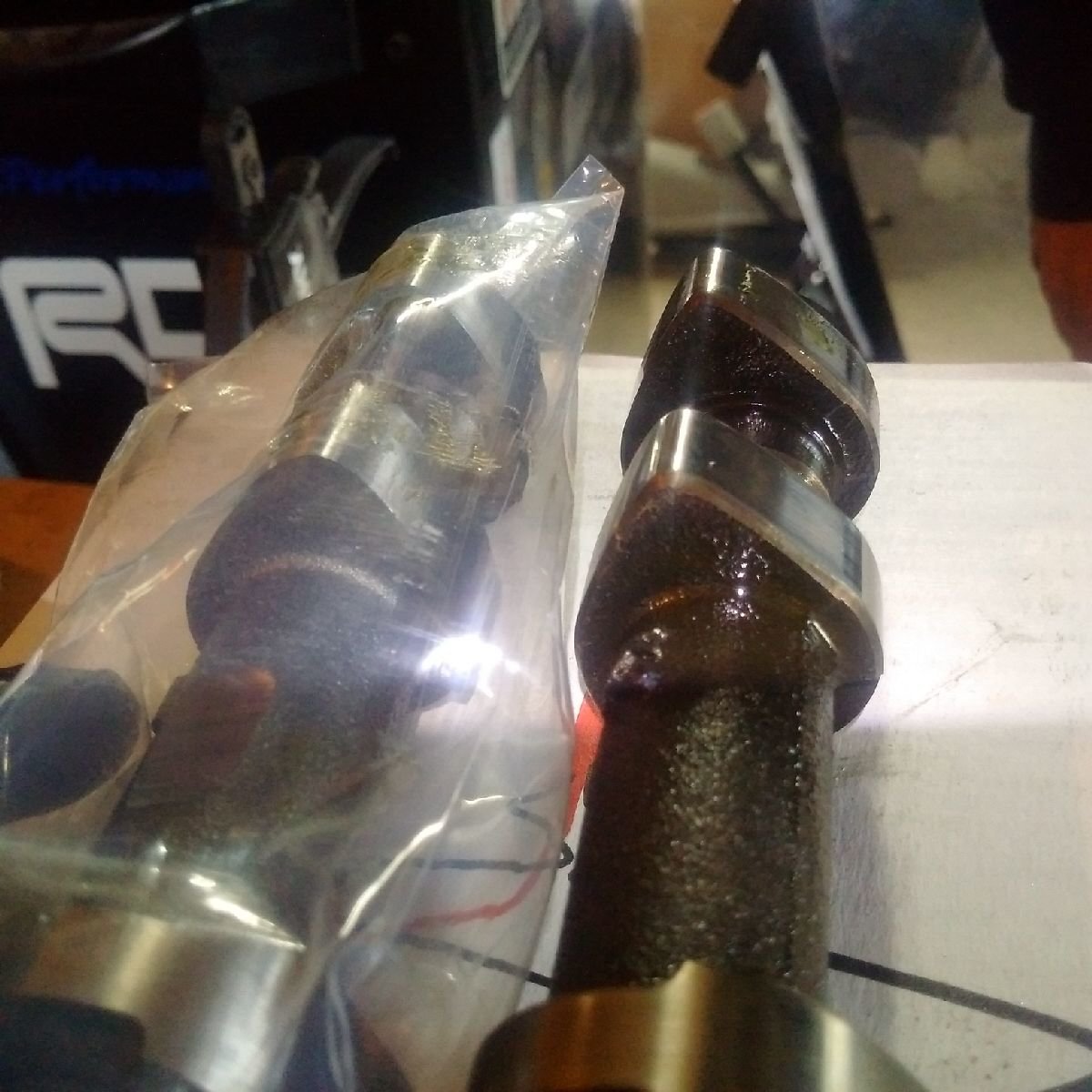

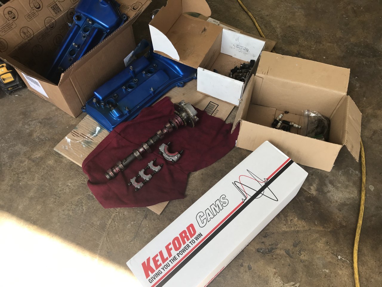

    Here's a few pictures showing the difference between the cams. I haven't measured the difference in lift yet, although it can't be more than 2mm... but the profile itself is quite a bit beefier (these are exhaust cams, my intake cams are almost exactly the same profile according to my card).

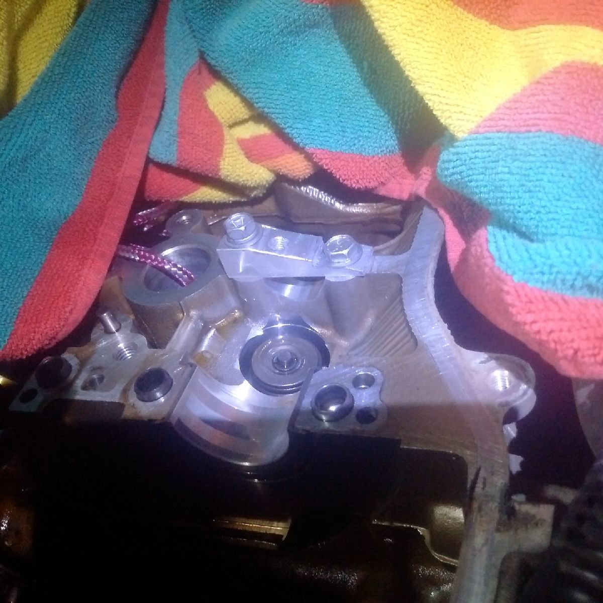

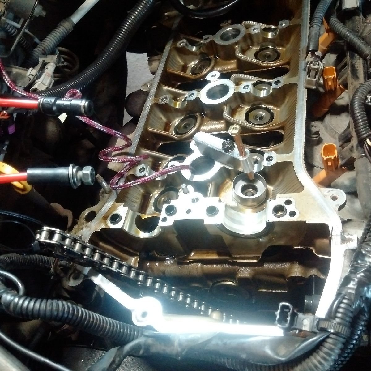

    And there's a picture of me attempting to use the spring compressor for my car, however it's going to take some modification. Slow going and I'm not trying to rush through it, but it's going.

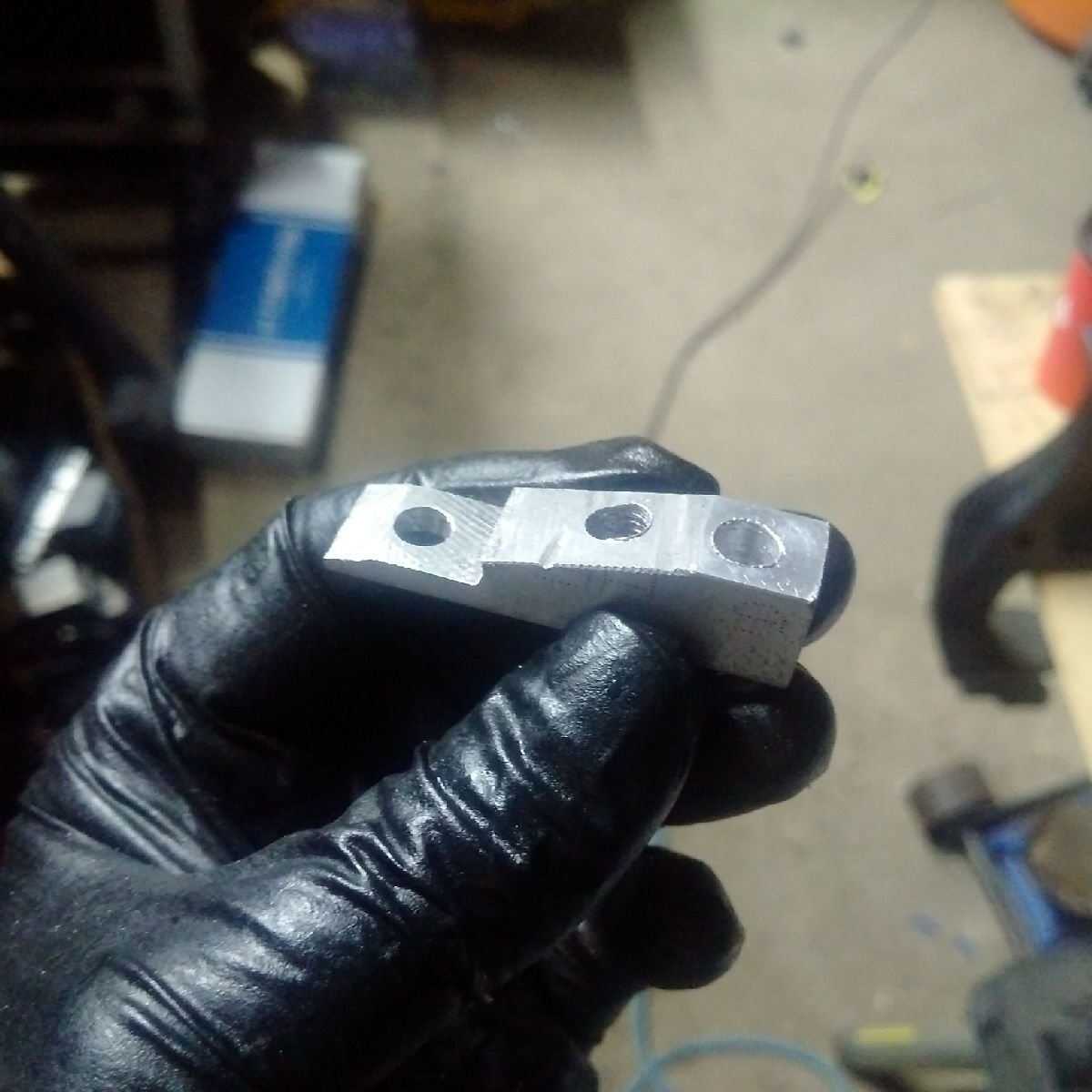

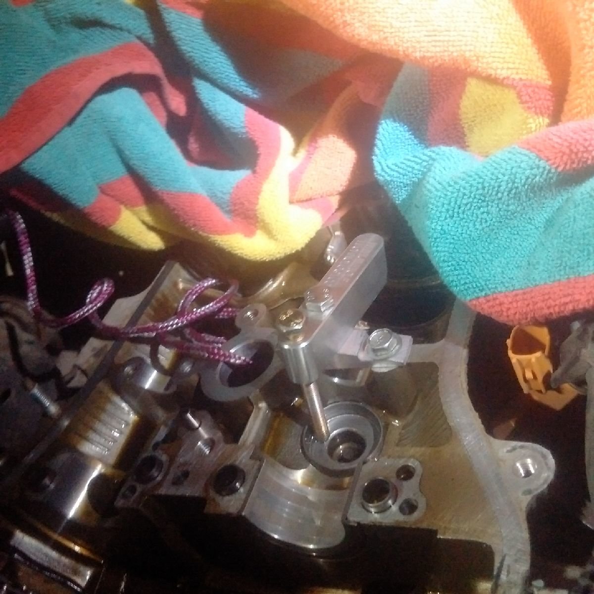

    In other news, here's the adapter I made for the JWT spring compressor. Just needs a longer bolt now, which I ordered from Amazon and should be arriving in my mailbox tomorrow.

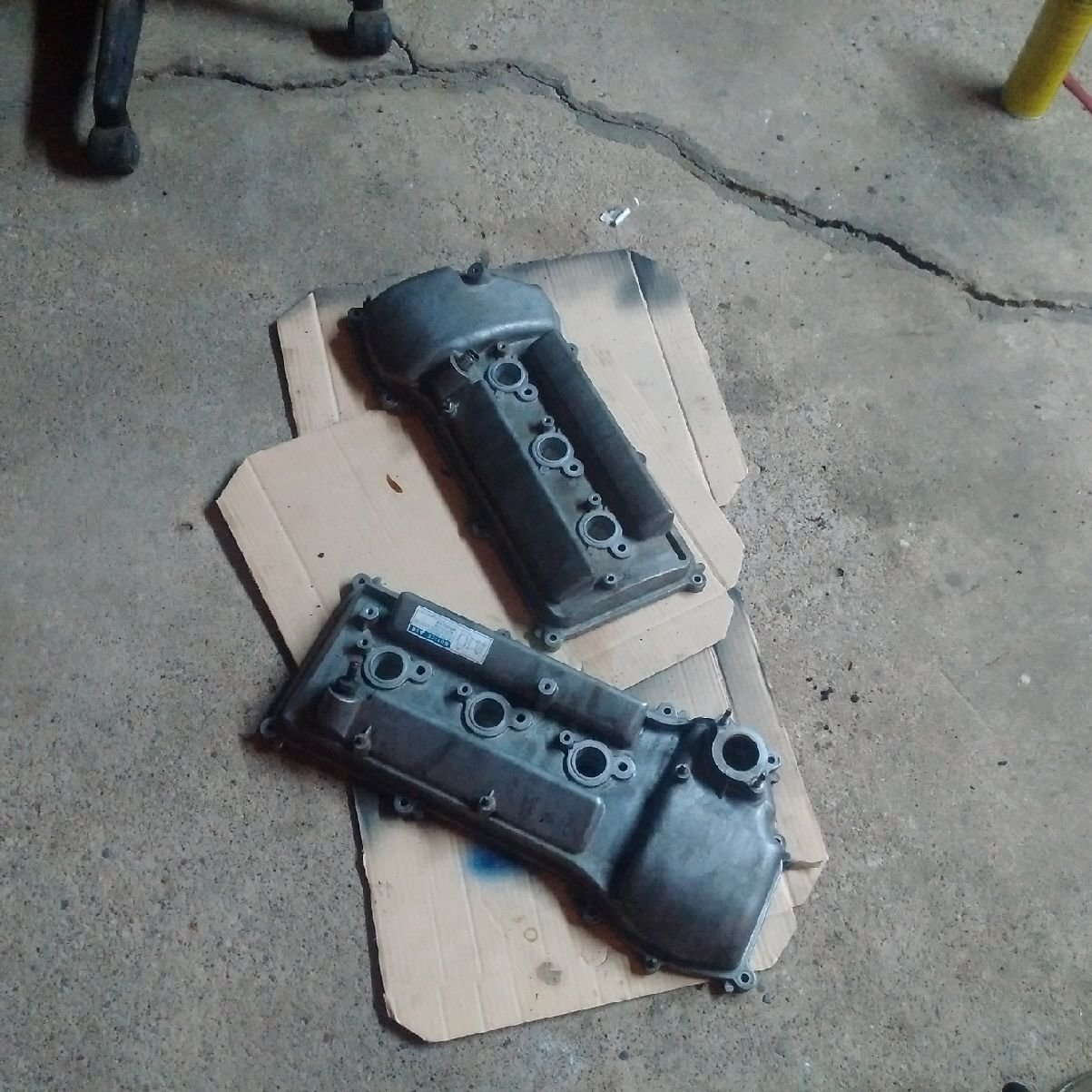

    Getting ready to paint the valve covers while I wait for the rest of the spring compressor to arrive.

    Got my threaded rod for the spring compressor yesterday so I’m crossing my fingers I’ll be able to replace the springs on the right hand side this evening.

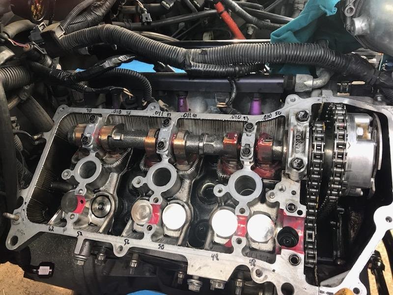

    Brian Crower stroker kit, Carrillo pistons moly/ceramic coated, BC sportsman rods, arp s2000 head bolts, Darton M.I.D sleeves, Kelford race cams, Magnusson supercharger, hp tuner tuned, 650cc flow matched fuel injectors, CSF radiator, Walbro 255 fuel pump. pulleyboys quick change pulley with 2.3", fpr mod, NST crank, water and alternator pullies, 160° mishimoto thermostat. Puma On-board air, Radflo CDC ext coilovers with 14" 700# springs, extended length rear Radflo shocks with CDC, Dakar leak pack, Brute Force Fab front bumper galvanized and powder coated, DTRL mod, yellow fogs, fog anytime mod, relocated rear differential breather, synthetic fluids, custom airbox, tundra sized intake. 76mm throttle body, secondary air filter removed, Airflow snorkel, 4x innovation sliders powder coated, URD equal length headers, DT y-pipe, Aero-Turbine 2525xl exhaust dumped over axle, seat belt chime disabled, Warn 8000i winch, 1- 20" slim light bar in grill, 42" curved roof light both with custom brackets. Mesh grill, Brute Force Fab rear bumper with extra reverse lights, u bolt flip kit, SS extended brake lines, hockey puck bump stop extension, AT shackle flip kit, Light Racing UCA's, 4crawler 1.5" bodylift. custom built front and mid skid plates, re-geared to 4.56s, windows tinted 25%, Sony stereo, 8" skar sub-woofer, 1000 watt mono amp, retrofit headlights with legal demon eye, Kryptek Marathon seat covers. North Star agm 27f battery, Helo 791 rims, 315/75/r16 Mt/r ARB front air locker
    Same stuff you would use for the stroker crank too? Making progress on disassembly over here.

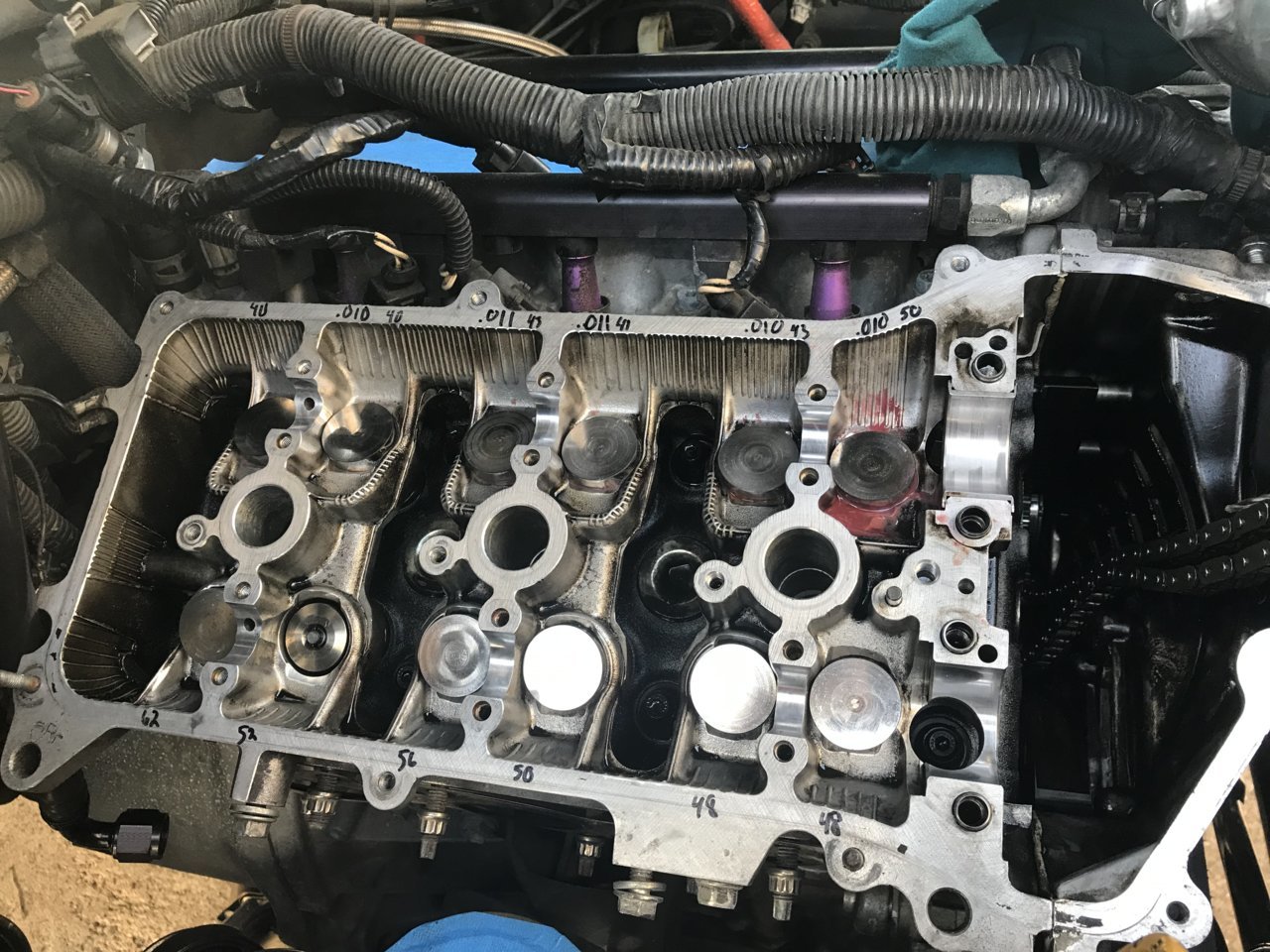

    I gotta just say this low mileage engine looks brand new! I would have liked to have seen the truck is was pulled from. I'm done working on it for a few days. Need more parts to come in and the money tree to grow a bit.20190928_140330.jpg
