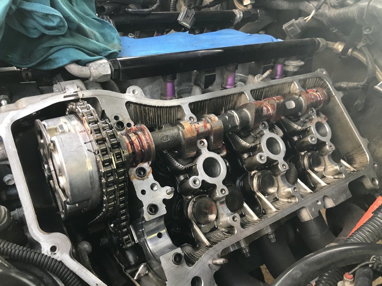

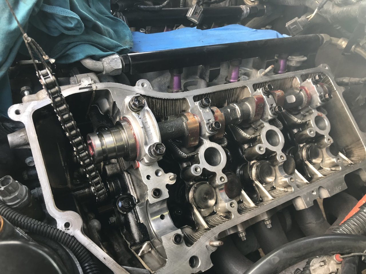

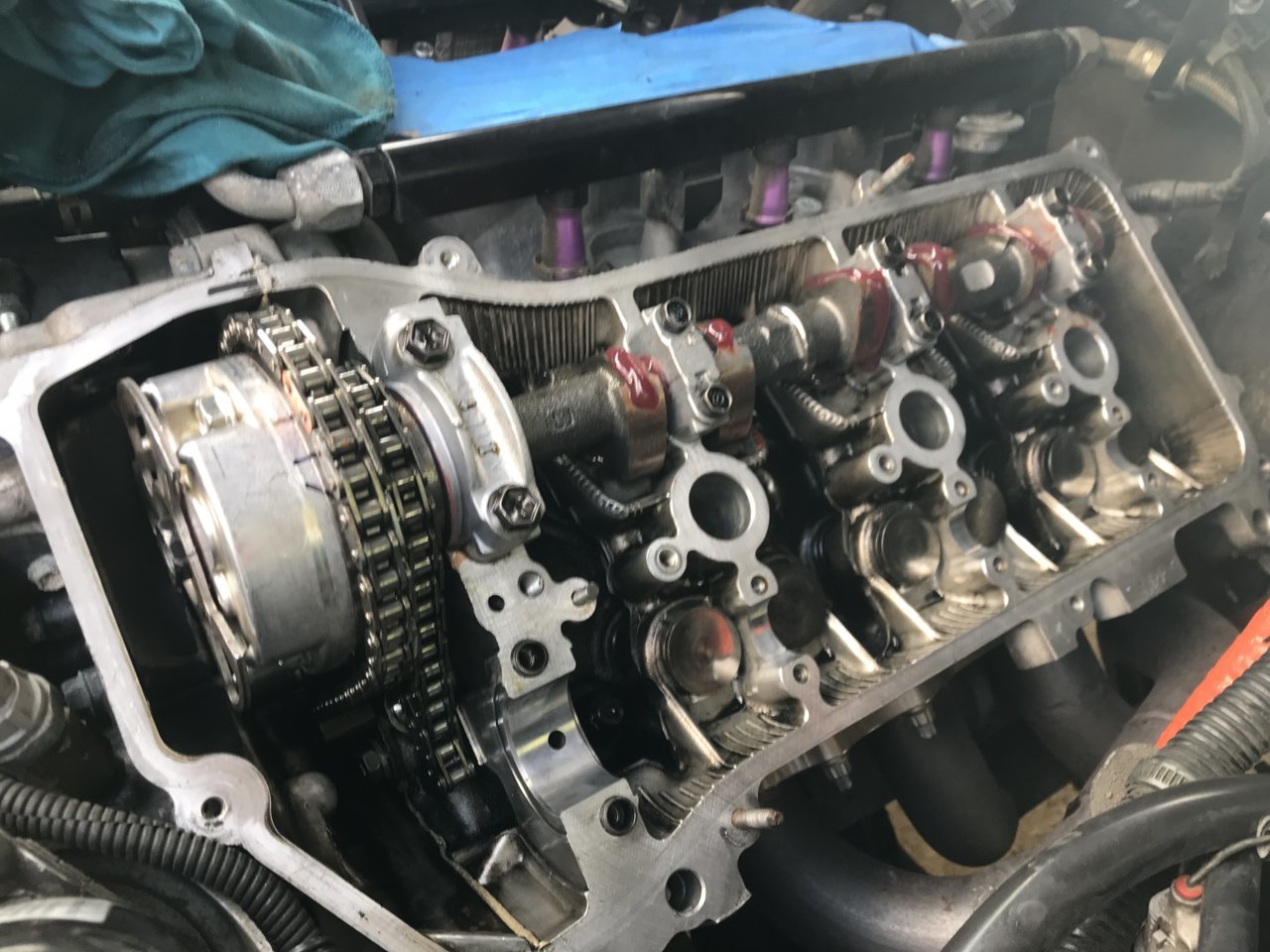

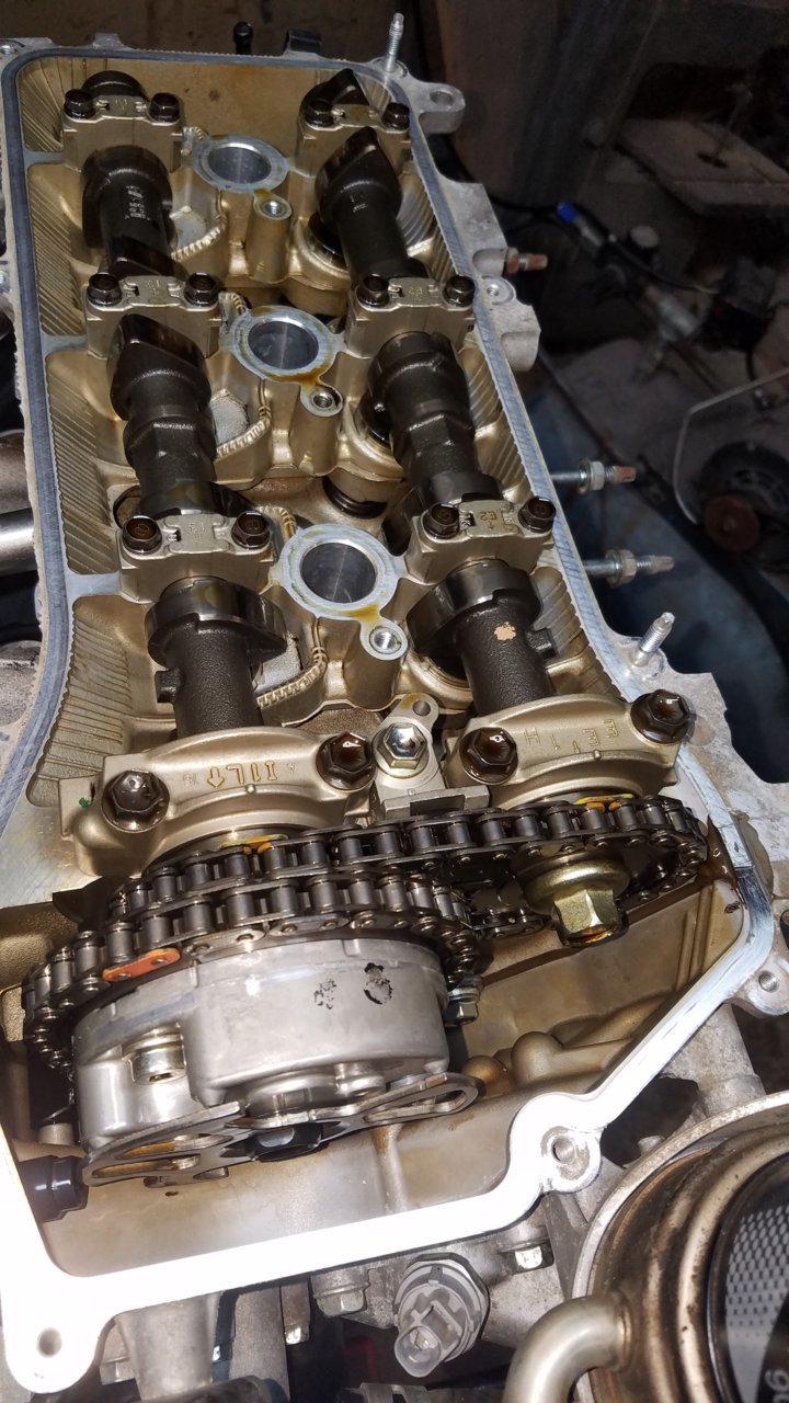

    Progress before lunch break.
    5A46476F-B983-4135-B939-52ED4BF11FEE.jpg 86964F3F-EAA3-40D7-9450-E612B4BF0359.jpg 906CB488-BBAD-437E-A614-F79DEF59202A.jpg

    Exhaust cams after lunch. Hard portion behind me now. :woot:

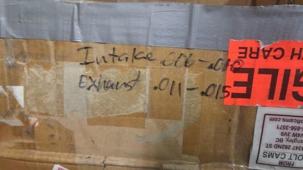

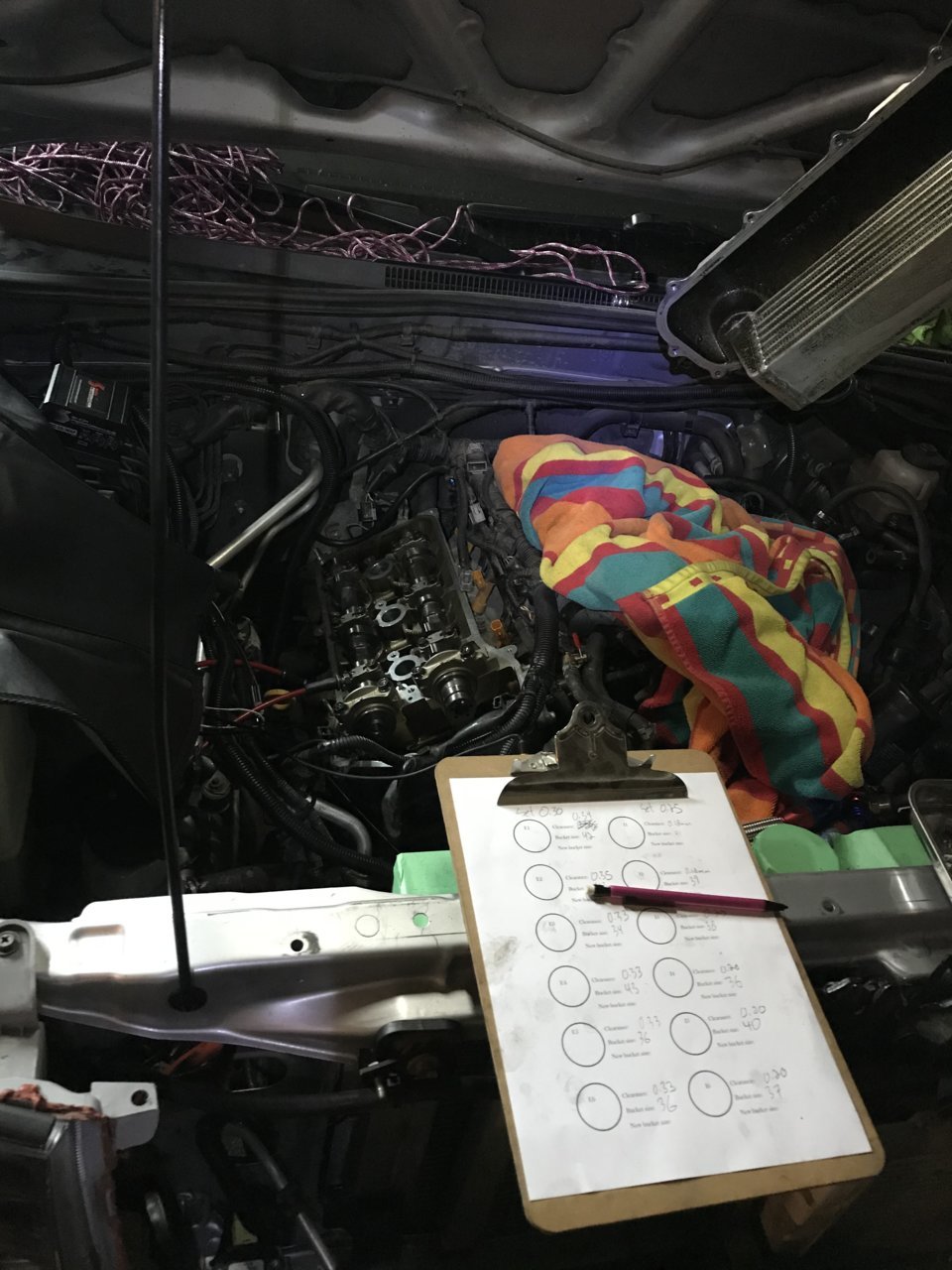

    @Torspd you’re going to finish before me by the looks of it. Stalled a bit on my camshafts because life, you know how it goes. But, I measured the clearances on the RHS this evening. No such luck as you, I need all new buckets, but I will be able to swap two of them to other spots at least...

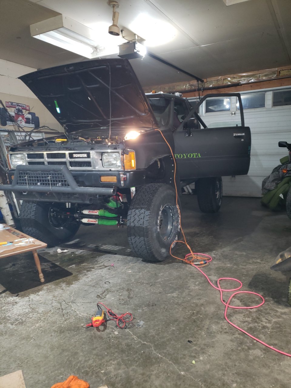

    No money for cams yet boys but this is my income project at the moment.

    Whats the sheet you have there? That looks helpful. Also did I miss the pdf on how and where to measure clearances?

    Three of my driver side exhaust buckets are at the largest gap. All of of the passenger side buckets are at the largest gap. I'll get those at a later date, since the exhaust buckets are super easy to swap in.

    I am using the attached PDF for clearance measurement. I have also attached that sheet I was using. I made that myself, I'm proud of it... well, not really, but it works.

    All torque'd down!
    I cheated though. Had all of my work done years ago. :D

    Checked clearances yesterday. Every intake was 0.006, with every exhaust being 0.012 on the factory cams. Installed the Kelford cams to check clearance on them and not a single number changed. Very impressed by the QC on these.
    Roostfactor, Hawk373, Athlaos and 2 others like this.

    I didn't get a baseline on the stock cams, but when I checked the clearance on the Kelford ones, I had the same readings as you.
