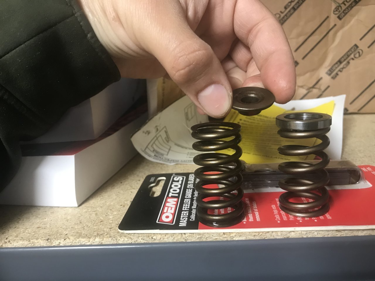

    Just to make sure I’m not over thinking this. Is this how you guys installed the new springs. With these new caps then retainer caps on top?

    No the new little caps/washers go on the bottom. Take out the washers that are already there with a magnet.

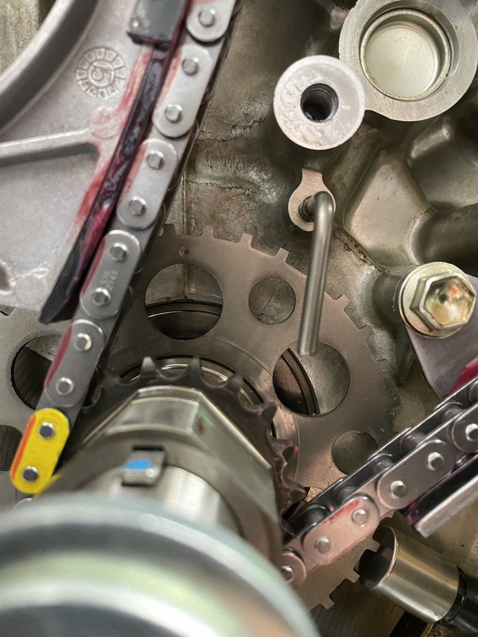

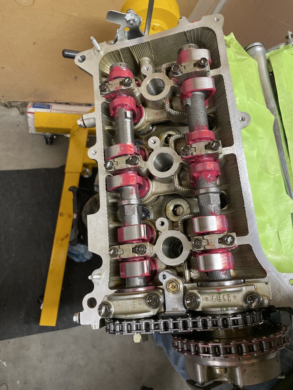

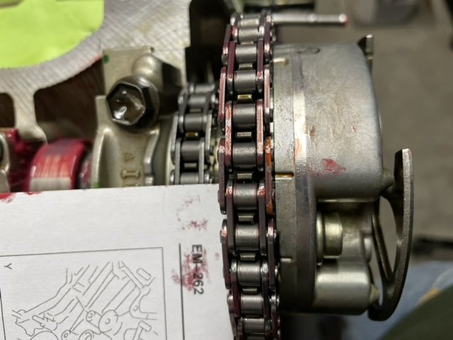

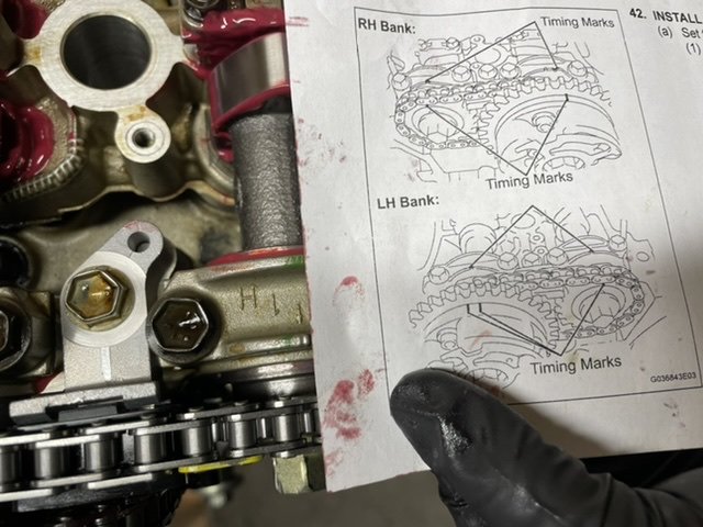

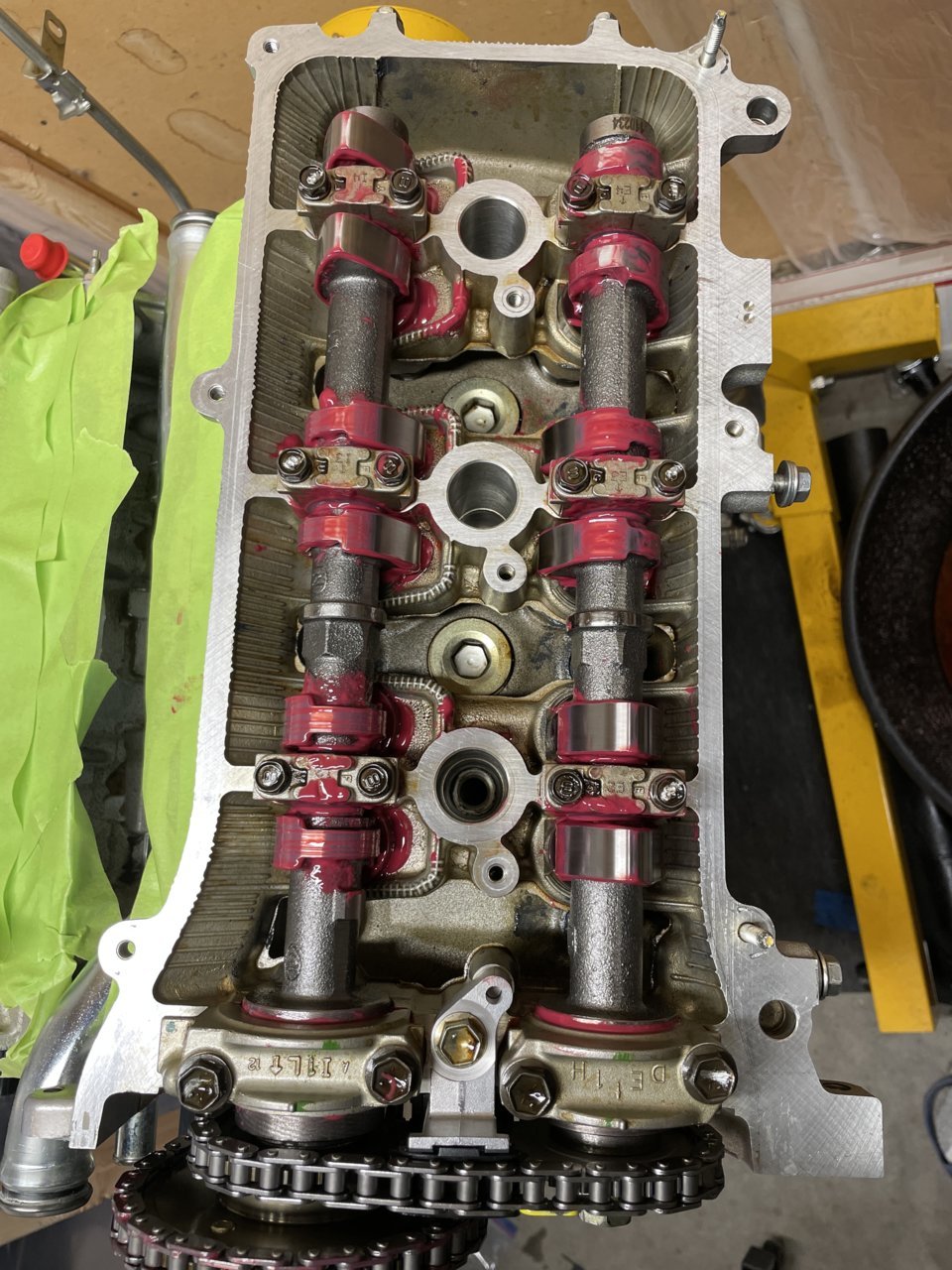

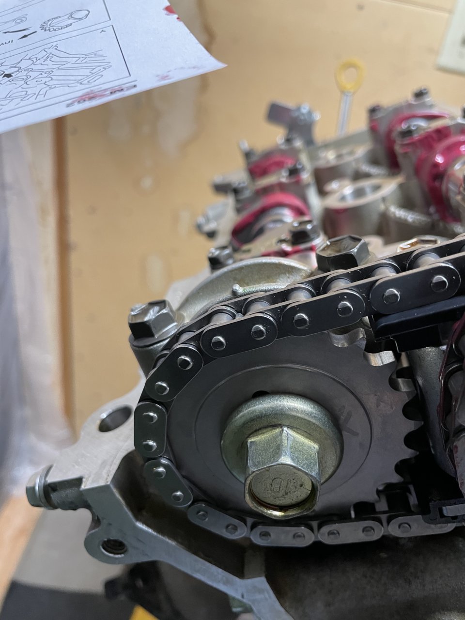

    Installed the cams. Clearances are all within spec. Getting timing chain on.

    Also have kel’s cam gears on.

    I keep running into missing ingredients. Gotta go to The dealer tomorrow To get the right sealant for the timing cover. Uses a coolant-proof sealant around where coolant flows. I should hurry up though, colder days are coming.

    08826-00100.
    Nobody ever uses it tho. It's uh, spendy. 999 out of 1000 techs just use the regular FIPG for the whole cover.

    As an additional alternative. The Mr. Gasket 1 minute gasket maker works well for both oil and coolant.

    Thanks for the helpful advise. I had bought the gears before the cams. Off they come. Maybe on a future engine if I destroy these cams.
    now onto Napa for some Mr gasket.
