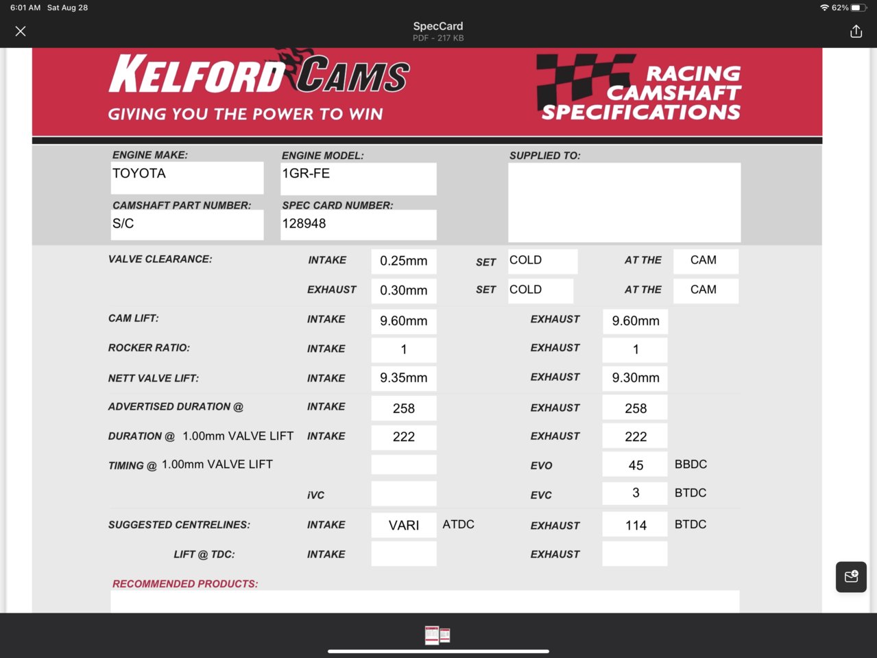

    If anyone has a legible version of the kelford cam card for a supercharger, will you share it? The resolution of the cam cards posted make them difficult to read, well impossible for me. Thanks in advance.
