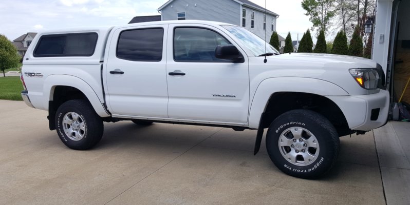

    Heavy kit install went pretty smooth. It took the better part of 10 hrs all by myself, never having done one before. I ran into some difficulty with passenger front that actually took me about 3 hrs. Driver front only took 45 minutes.
    Final lift was right at 3 1/8 to 3 1/4 inches at all corners.
    Ride is nice, absolutely no complaints. Bumpers, winch, wheels and tires coming in the future.

    I'm guessing you stuck with the 886 coils? Truck looks good!

    Yes and thanks.
