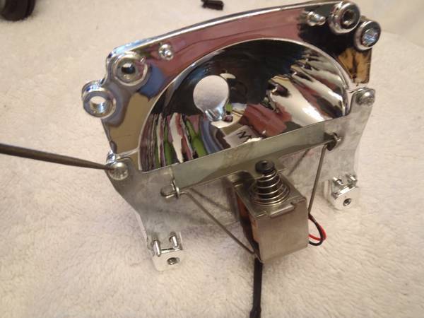

    So my solenoid for the high beams is sticking on one of my lights. I talked to TRS and they said to make sure the metal hinges are cycling properly and not getting stuck. Anyone know what these hinges look like so when I open them back up this afternoon I know what I'm looking for?

    Behind the lens.
    Remove the black plastic lens holder from the front of the projector and you'll see the solenoid, spring, and fence in front of the reflector bowl.
    There is a "fork" that goes along both sides of the plunger on the solenoid... make sure it is filed smooth on both sides.
    Ad the ends of the fence, the small tabs pivot inside two tabs with holes in them on the mounting plate. Slightly spread those tabs, and operate the mechanism to make sure it runs smoothly.
    Wouldn't be a bad idea to apply some dry graphite powder to the ends and to the solenoid plunger where it contacts the fence.

    First post in this thread has picture of what Rich is talking about:
    http://www.tacomaworld.com/forum/lighting/259416-started-my-d2s-retrofit.html

    Just took a look at it, it wasn't smooth so I think that may have been the issue.
    D2S
    Nope. It was working fine though before I sealed the headlights back. I used a crappy set off an 06 as my retrofit lights and the lenses looked really bad, so I swapped out to my stock lenses as well today.

    One question though. It seems to want to stick about 1 out of every 30 times. I've noticed the angled piece that runs below the projector can also have an affect on it sticking. What is the purpose of this piece? If it's pushed towards the lens, it will never stick. Only when it gets moved back towards the rear it'll think about sticking. What I'm referring to is the upside down pyramid shaped object in this picture:

    The wire?
    I think that holds the solenoid in position.

    Like I said it seems that when it's pushed towards the lens it never sticks because there's enough force to get it to release back and not stick. I might glue that so it stays put.
