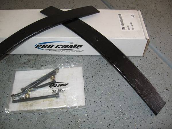

    Okay, for those of you that feel this thump while at a light... Do you have any sort of lift on your truck?
    I to "had" this problem when I had a spacer in the front and the TSB done in the rear. Today, I am running Bilsteins in all four corners and also have an Add-a-leaf in the rear. I don't feel the "Thump" anymore, BUT I do feel the truck shake in increasing speeds. There is a fix for the too, but haven't done it yet.
    Either way, I'm under the impression that the truck has to be perfectly right between the front and the rear in order to not feel any of these nuances.
    Add-a-Leaf used on my truck.

    If you're interested in a solution...check this out.
    http://www.tacomaworld.com/forum/1st-gen-tacomas/108316-goodbye-axle-wrap-mod.html
    It's in 1st gen forum, but they have the same problem as do lots of people with other Toy's as well as Fords, Nissan's and anyone with progressive rate leaf spring suspensions and auto trannies. A split-shaft drive-line makes it even more likely you'll experience it.
    I used the helper spring solution (others say just the clamp does it) and those annoying 'thump' at stop lights from the sticking splines is gone now but I also noted just how much the helper spring added so much to throttle response. When I punch it the truck just goes now, with no hesitation as the axle winds up. Ever so much nicer than the mushy feel it had before, especially in a turn where predictable performance is most appreciated.
    Axle wrap causes a lot if issues: the thumps we feel as the sticky spline lets go, the mushy throttle response I notice. The speed crowd have big time issues when it causes wheel hop on power take-offs when drag racing. These are not new problems and the solutions are as low-tech as it gets but time tested!
