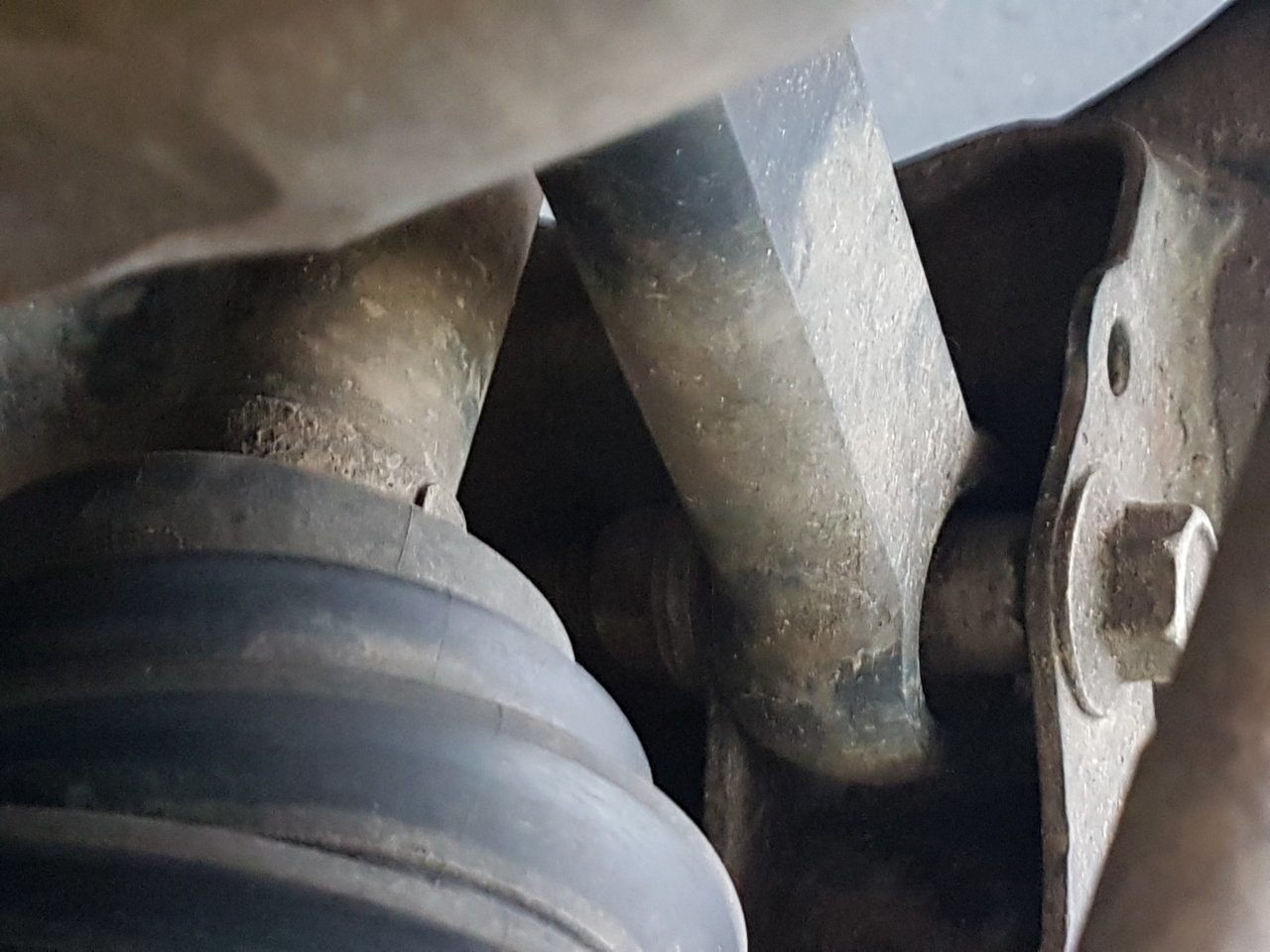

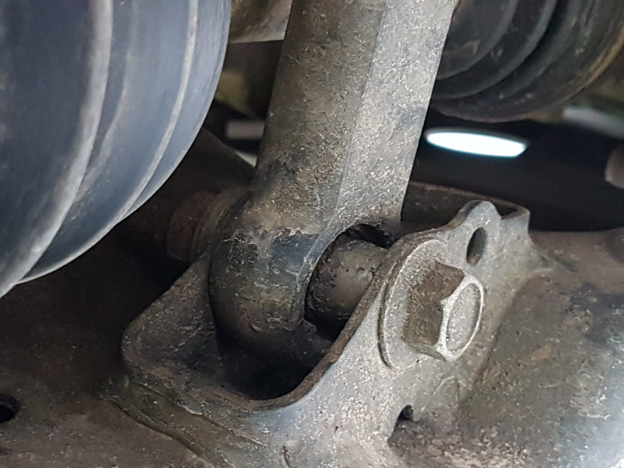

    I know there's other threads about this but so far I have some info on it or at least an idea where its coming from.
    Fox 2.5 extended. The shop I deal with believe its coming from the lower shock mount where it sits in the LCA, although there are misalignment spacers the shock does not sit tight in as it doesn't have bushings (different shop did install and this is how the shocks came)
    The shop I deal with agrees there is a sound, but haven't found anything that could be causing it, checked all steering, LCA, UCA, sway bar etc. The only thing they can find is that lower shock mount which does move as when I first brought this to them they mentioned the lower shock had shifted and was turned slightly, suggested lift it up to take weight off and put a pipe wrench on and turn it back straight so the mount isn't contacting the LCA. Did so, but it still shifts back and moves with the suspension travel.
    There is wear on the mount where you can see some of the anodizing coming off from rubbing. Everything seems like yes it is coming from there, and suggestion was to put bushings in which will help hold it centre and not allow it to shift anymore. Shop has assured me this isn't really a issue in terms of it will break but its just annoying.
    Basically just wondering if anyone else has had this issue or has another idea of what it could be if not that to check out.
    Next year when I do my ARB bumper I'll also be swapping to 700lbs springs so at that time when the shock is out the plan is to add the bushings since this really isn't causing any issues besides noise and I only hear it if the radio is off.
    I haven't been able to catch the shifting on video to verify because can't find a place to mount camera where it won't get hit or something and have the angle to see it but can definitely hear it on video.
    Sound is from both sides depending on which way I'm turning etc or which shock is moving

    actually since you mentioned that was the first thing I checked.
    since these use a swaybar relocate I had it hitting the bracing on the mobtown skids when the lift was first done.
    I since grinded that area of the skid away so its fine, when I started hearing this after the adjustment figured it was the skid again so dropped the skid but nope its fine. also drove around without skid to make sure its not coming from skid plates. still there.
    So seems fox said the same thing that the shop I deal with said, its not a reliabity/mechanical issue just annoying sound. I don't see why a bushing wouldn't fix it just want to be sure thats the problem before I try anything else. And you're saying you still have the same issue never found any other culprit?
    Cam bolts etc were all tight, and one of the techs there did say when he was riding with me he can almost feel it in the footwell of passenger side and at one point felt the vibration in the LCA, would make sense its something shifting in the LCA. When he felt it thought the cam bolts but checked to make sure they were tight no issues.
